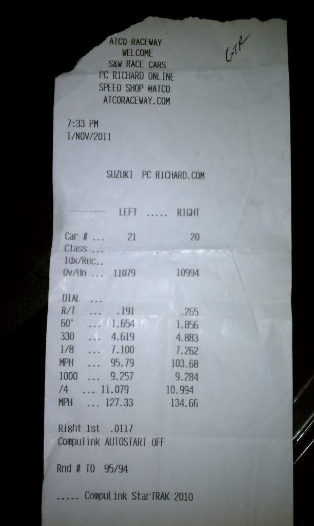

This was the first pass ever in the car with around 1k miles on our 2012 BE GTR. Stock with the exception of 20" Volk VRG2s with Nitto Invos. On the second pass it didn't launch as well and went about 11.2@126. The other car is a friends bolt-on ZR1. I launched it in R-R-R, when the track opens back up we'll try R-Comf-R. This was with about half a tank of fuel and shifting manually.
We can't figure out why the trap speed is so high. Are the VRG2s significantly lighter than our stock BE wheels?
1.654 60 foot
7.100 @ 95.79 mph
11.079 @ 127.33 mph

Your eighth mile trap speeds are WAY low to be trapping 127 on the big end in a GTR.  You should be in the 102 range at least.  32 mph on the big end isn't happening with stock hp either.  Something seems funny about this slip, may be the track timing equipment calibration.  Anyway, glad you guys had fun.

nice run, something does seem off with the traps....  ET is right on given the 60'.....

thats a great ET.... just  a bit lower  1.60  60ft would give you 10's no doubt......  maybe less gas and possibly  comfort mode like you mentioned will get you there.....  im  about  5 7 too weight about 135 so thats always a bonus at the strip!
as for the   trap...  its certainly the  highest weve seen and might be just a bit off in relation to the  1/8th like others have said...  the average mph pick up on a stock 2012 is around  24-26 mph(ish)....  when i  trapped  125.5  which i think is the  highest  stock weve seen until this...  my  1/8th  was only  99.2... the  same car at a different  track  trapped  102.9 and 102.4 in the  1/8th in cooler weather..... those were probably  126+ runs based on what ive seen

your ET lines up perfectly for a stock 2012 GT-R, traps not so much,  32MPH pickup on the back half is SUPER high....
when I trap 127.x MPH in my tune only 2012 with a 1.6x 60's I'm well into the 10's....  10.7x-10.8x.....
maybe a breeze of cool air hit the car half way down...  and brought the DA from -1500 to -2500..  :)

1.  The trap is likely off.  It happens. I have seen it a lot.  Traps are not nearly as accurate as ET.
2.  The wheels with non-runflats will likely give a big reduction in unsprung and rolling weight, leading to a better ET and trap.

1. I can definitely see the trap being off as opposed to the ET.
2. I'm sure that even a miniscule amount of less rotational mass helps the car, especially in the last 1/8th.
3. Not that I've ever noticed, maybe only the second half. :)

Black edition wheels by themselves  are lighter than stock 2010 wheels so his weight savings would be less than
14 lbs...
BE wheels alone  are 22.7 and 23.8 lbs   G2's are  25.2 and  25.8 lbs according to my  #'s
but with the nitto vs  oem tire   the  G2 nitto set up is gonna still be  a bit lighter
