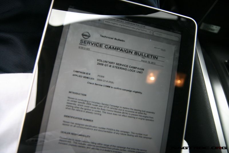

Step 0: Print Nissan's isntructions (pdf link), or put them on a device to have with you.

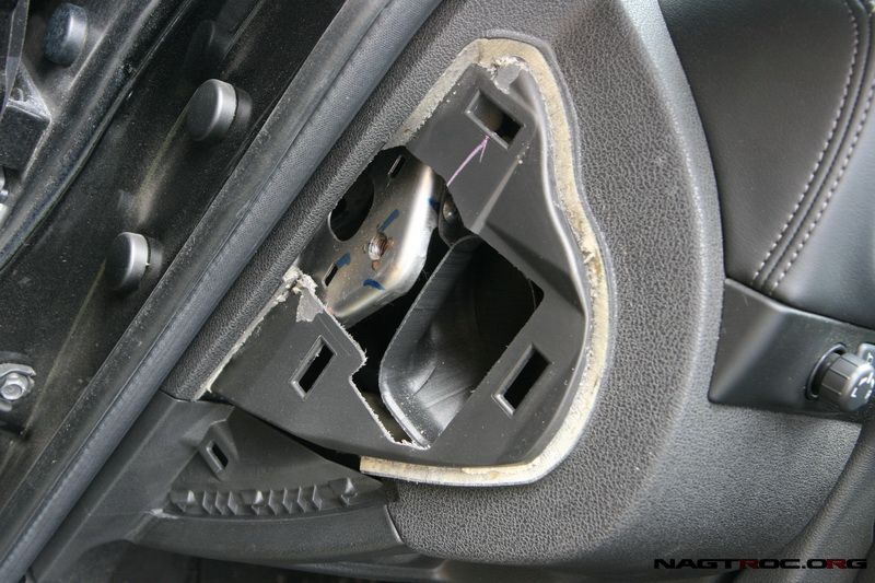

Step 1: Remove the driver's side side trim:
To remove this, you want something thats thin, flat, and not too sharp so as to damage anything. Use it to pry the piece off. Look at the pic above and below to see how the two parts come together and where the clips are. Once you get one of them off you can work your way around to get the others off. It's not on too tight.

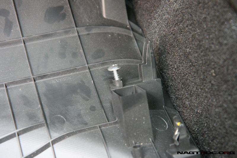

Step 3: Remove the two bolts for the hood release handle. Position your hand under your tools in such a way that the bolts cant fall into that gap(!) See the above pic. The two bolts to be removed are to the left of the OBD2 connector.
Step 4: Unsnap the panel and pull it down a little: Don't pull it down too hard/far because there are still cables connected! It should just snap out and come downward. Peaking ahead, this is a view of it removed so you can see where the clip locations are:

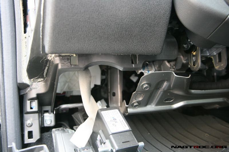

Anyway, as you pull down slowly, it will stay attached and look like this:

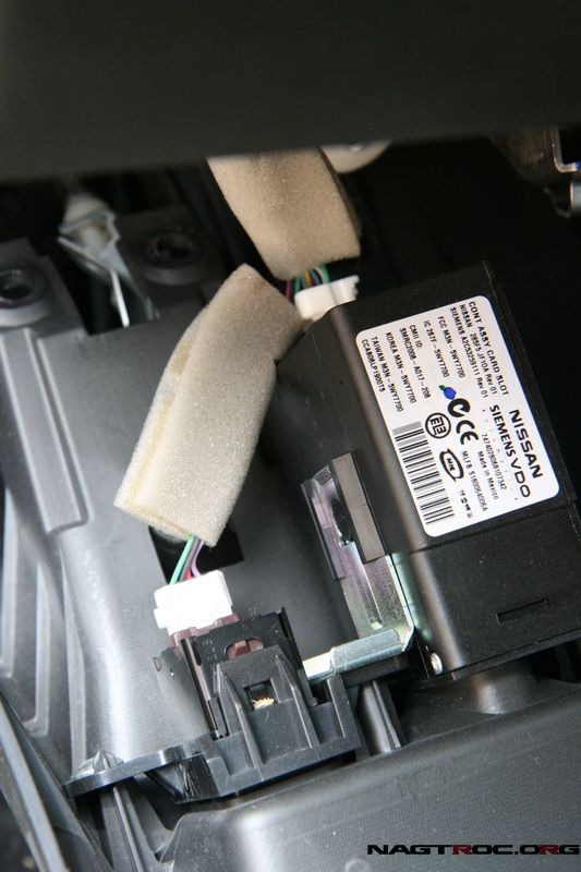

For the first time you will get a glimpse of the lock unit:
Where you're at:

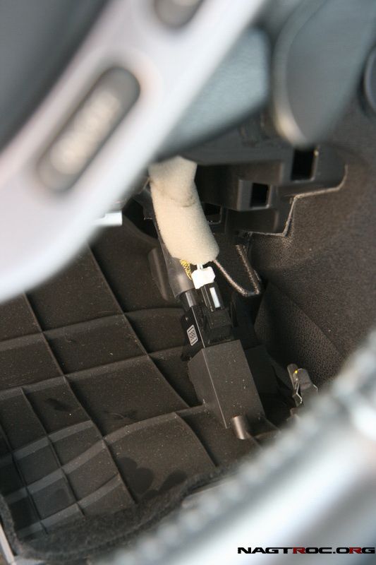

Step 5: Now you need to remove the wire harness plugs:
On the right side you need to back out a screw. This isnt in the recall directions, but you'll need to do it. Be sure not to damage anything!

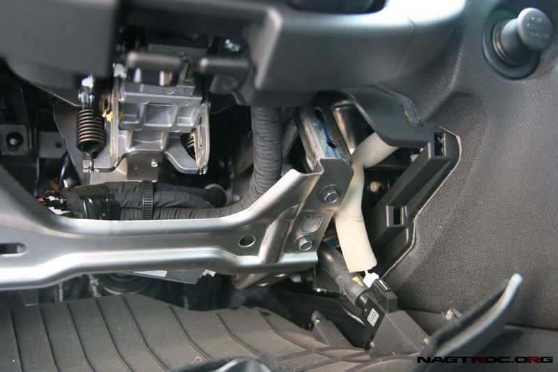

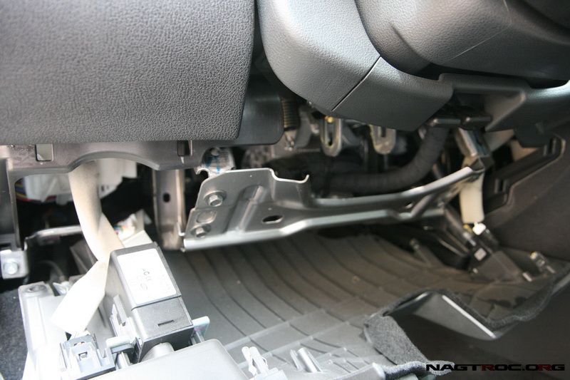

Step 6: Now you need to remove the 4 bolts holding the metal panel that protects the steering column assembly:
You will go from this:
To this:

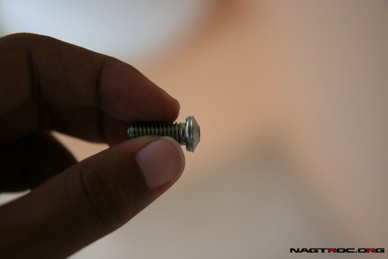

Step 7: Now the steering lock unit is very visible. All you need to do is take out two bolts and it will come out of the steering column assembly. The only issue is that it's retained with tamper resistant bolts. These bolts have a separate hex piece that breaks off when torqued, leaving a surface that you can't put a (normal) bit on. To complicate things, the bolts are recessed in metal and there isn't a lot of space to work with. This is what it looks like:
There are a number of tools that could probably get to them. The solution will depend on what you have available to you. From what I've heard, the tool dealers use is a socket that tightens on the bolt as you apply pressure. I didn't have something like that, but luckily (thanks to the wifey who makes jewelry) I had access to something else that worked very well. It's a sort of needle nose pliers thats curved. It allows you to get on the sides of the bolt and untorque them which works because they arent tightened with a lot of torque. It took maybe 10 mins with this tool.
This is what the bolt looks like that you've got to take out:
This is what the tool looks like that I used, and how it can grab the bolt:
(note you can see the hexes that break off in this pic as well)

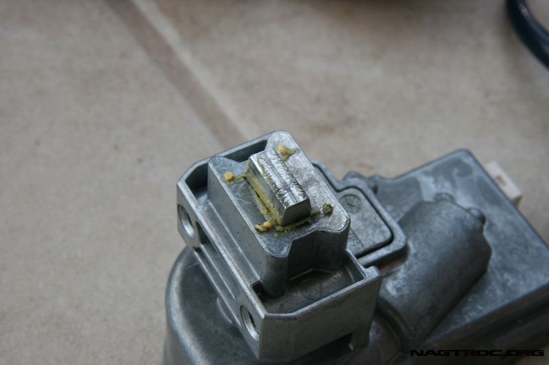

The old steering lock unit as well as the new one (not in focus):
The old unit:
