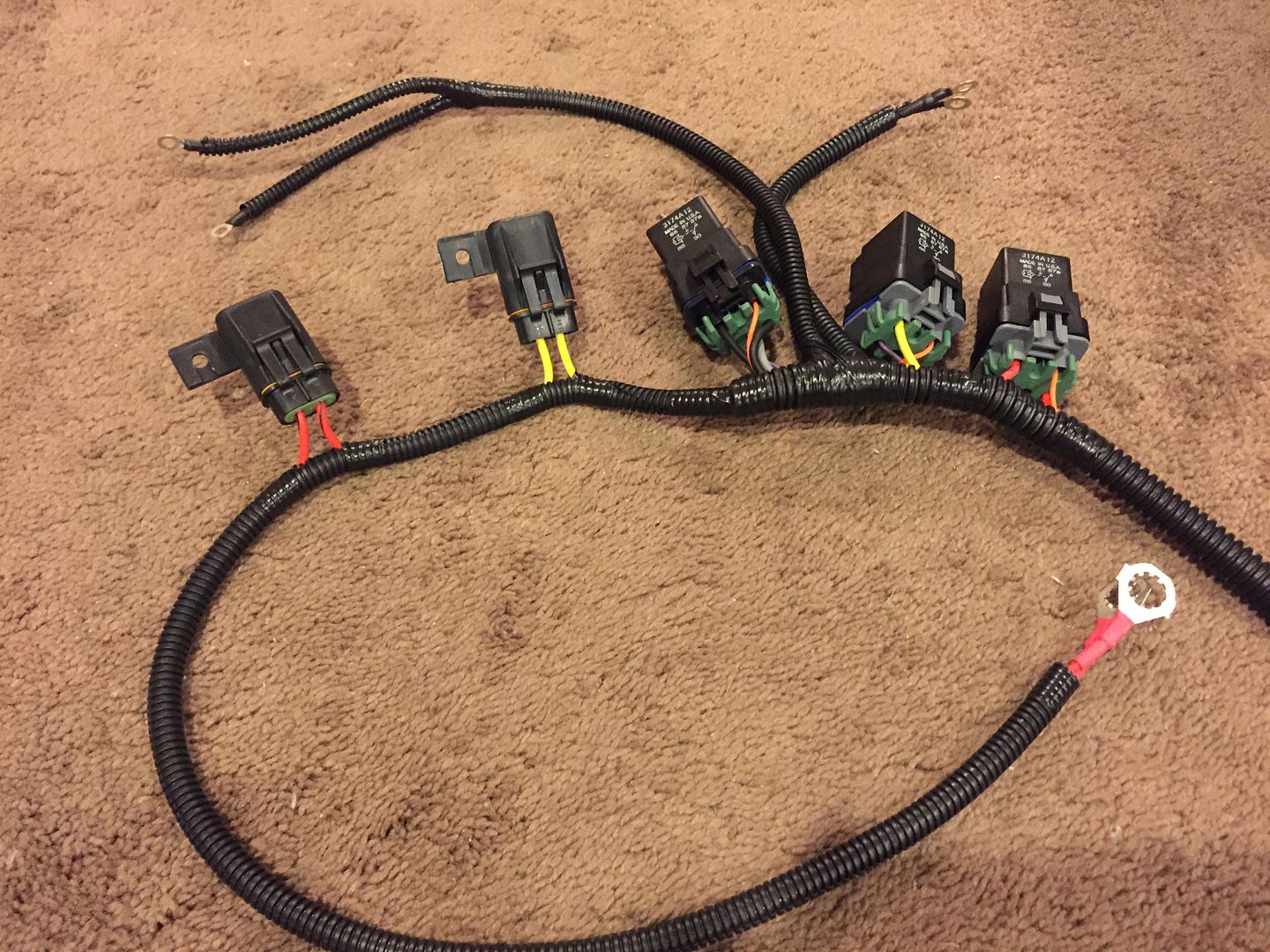

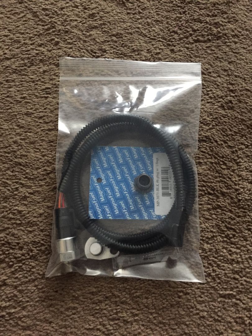

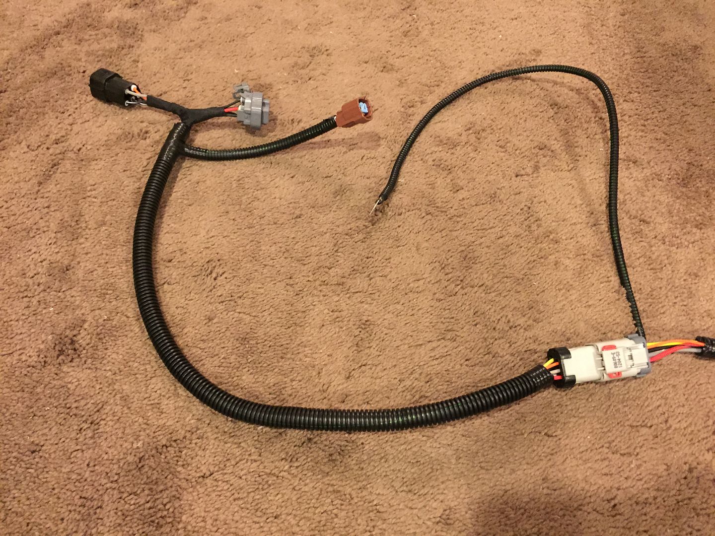

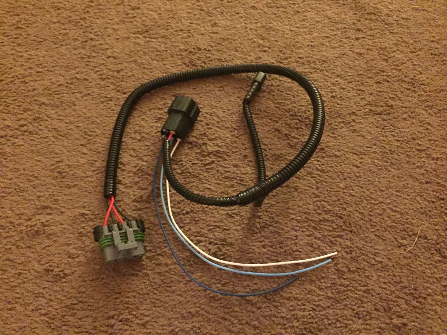

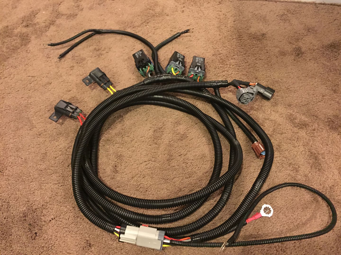

After extensive testing I'm proud to announce the very first completely Plug & Play Fuel Pump Hardwire Kit for the GTR.
This PNP Kit bypasses the factory voltage limitations on stock wiring by direct wiring fuel pumps to battery. It'll increase power output from 12V to battery voltage (14V+). With direct battery voltage your are now able to maximize the pumps flow, allowing for more head room on cars with injectors that are maxing out.
A not so well known issue with hard wiring upgraded fuel pumps is it can overrun your fuel pressure regulator at idle, causing your fuel pressure slowly to rise when it shouldn't. This kit solves that problem because it still allows the fuel pump controller to switch the primary pump from low, medium and high speed.
The kit comes in a carefully prepared two piece wiring harness. Relays and fuses are placed at the beginning of the harness so they can be close to the battery.
You literally connect the one end of the harness to the battery and the other connects to the fuel pump basket and factory engine harness.
Everything is plug and play so the kit can easily be uninstalled at any time - No more cutting the factory wiring harness!!
The kit can be purchased directly off my website - Here
For those interested I'll post up more pictures soon!

Here's a quick rundown:
You need to pull the plastic out from around the battery and carefully run my harness through the factory rubber grommet that allows access to inside the car.
You'll need to pull a few interior trim pieces out but it's fairly easy to run the harness to the back of the car.
Then you just pop the back seat off and get to the fuel pump harness that has two connectors.
You unplug the car harness from the top of the gas tank and plug it into my harness, then you plug my harness into the top of the gas tank.
You'll remove the seat belt bolt and place a ground that comes from my harness around that bolt
Then you just need to connect front of the harness to the battery.
During WOT conditions my kit bypasses part of the fuel pump controller, which will eventually causing DTCs.
You'll need to have your tuner disable those codes.
My long term goal is to make another kit that doesn't cause any DTCs but it's hard to get some of the connectors I need to make it completely Plug & Play.
Even then I don't know if the Fuel Pump Controller will be happy or if it can even supply the pumps with a solid 14v with better wiring.
What I do know is almost every week there's a few more cars that go under the knife because there's no plug & play solution. Half the time people aren't even wiring things up correctly and you still have to end up turn off DTCs. It's time we stop cutting up the harnesses in these cars!
I also make another version of this kit that uses a HOBB Switch to trigger the second fuel pump, I plan on doing a few more kits for some of the other popular aftermarket fuel pump systems.
Hope that helps
