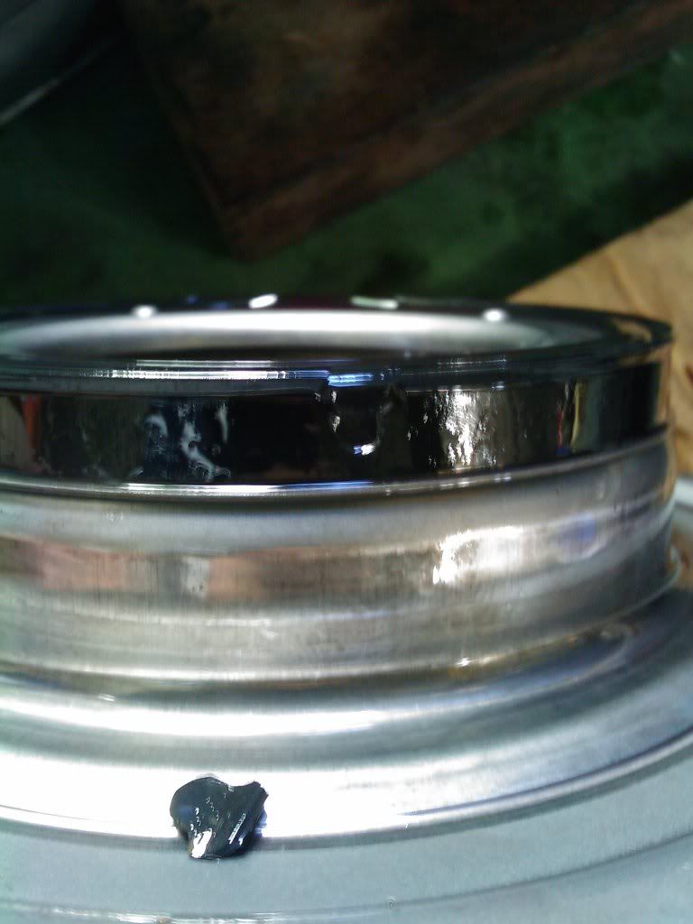

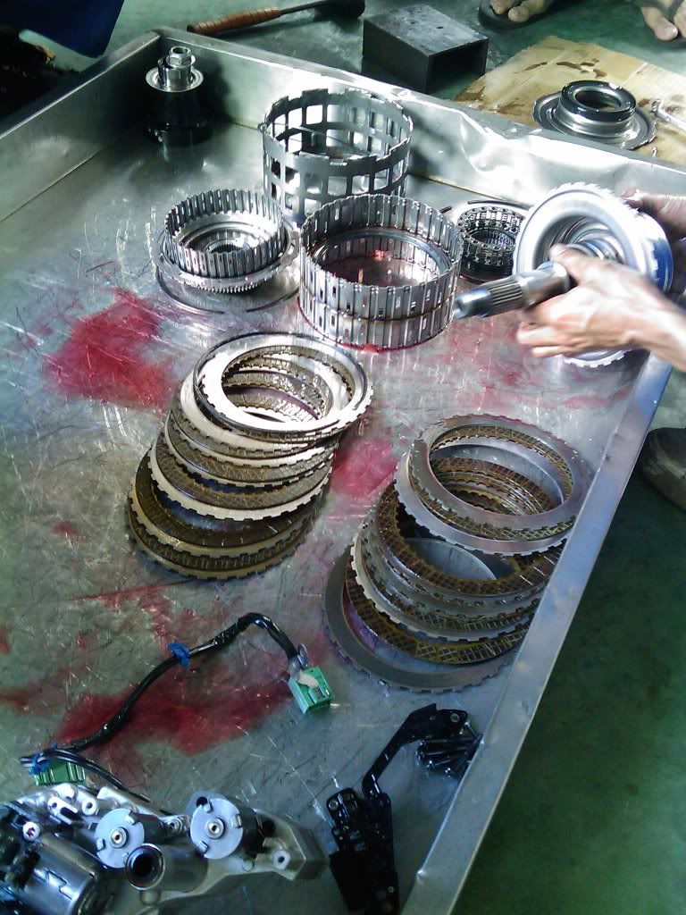

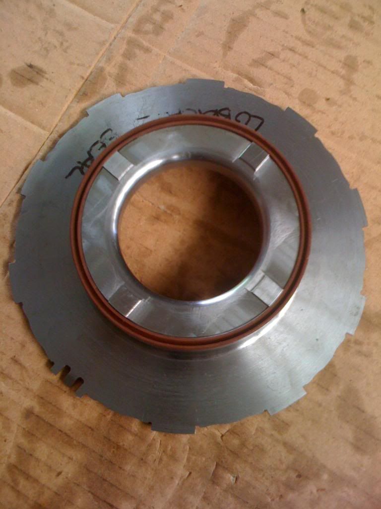

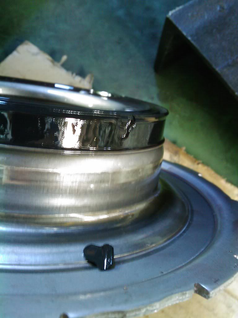

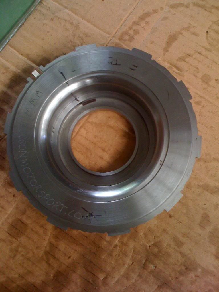

#5 Posted 27 June 2009 - 01:53 AM
Good old P0797
That is the seal that has failed in the clutch pack A.
You will need to pull out your gearbox and tear down the clutch pack too.
I had mine go down the same way but it can be fixed for around $1200 u.s plus labour.
Dodson motorsport made this replacement seal, works great and it much stronger than the original seal.
4200ks and still holding up strong and some guys from Singapore are also using them.
Inside the clutch pack, you will find this..
Read this thread and you will on your way to fixing the car.
http://www.nagtroc.o...showtopic=28923
Good luck and don't stress about it, it's a simple fix.
