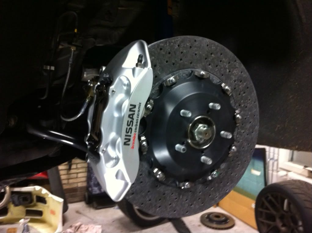

I know it works, i have the ZR1 ceramic brakes on my 2012 GT-R they work great.
Pics or this claim is worthless.

Here you go:
Sorry for the crappy Iphone pics.

Any trouble with mounting?

I had to do some modifications:
- new bells for the rear discs
- modification to front and rear back plates
The front disc are Ferrari California disc, only mod to make them fit is the diameter of the centre hole.
ZR1 disc will also fit. but you have to modify the calipers to fit the wider discs (36mm)

Posted 19 March 2012 - 10:06 AM
Weight saving is about 7kg (15.5lbs) at each rear corner and 5.5kg (12lbs) at each front corner

Amazing - but what are we looking at? Are these the Spec V calipers and the ZR1 discs?

Ferrari California disc & OEM caliper painted correct? The disk is 390mm just like the 12 & 13 disk I believe.

Make sure everybody notes that these are the SpecV Calipers. Because the SpecV rotor is bigger than the stockers, we KNOW that the either the caliper or the knuckle on the SpecV is different (and the general consensus is that is likely the caliper).
You will either need the SpecV caliper or a spacer to make this work.
