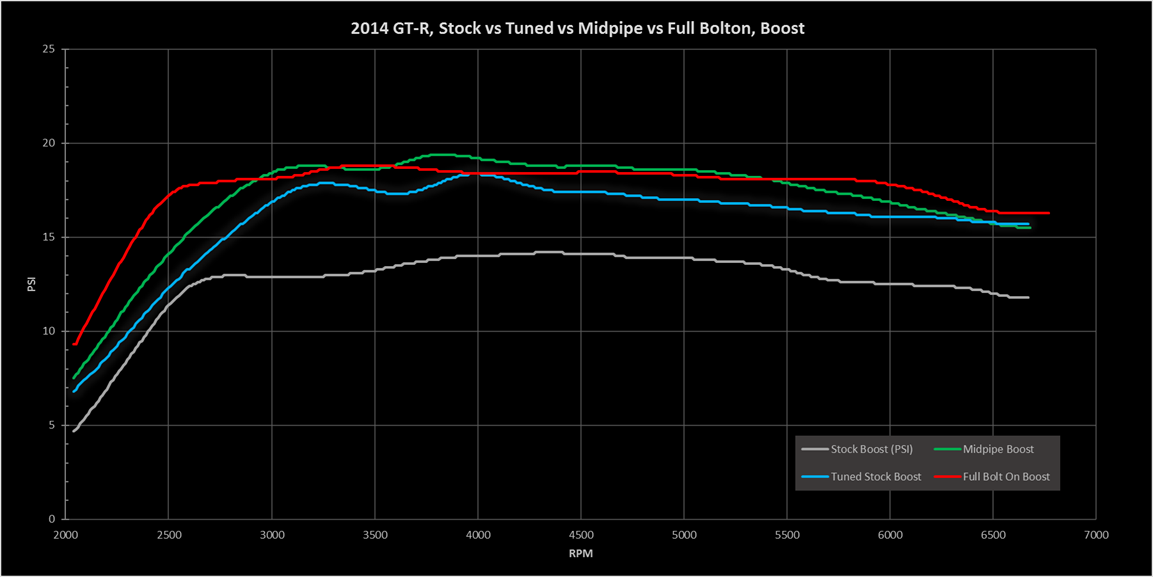

Also.. Take a look at this:
This shows the boost from stock, tuned stock, midpipe, and FBO. These are all on the dyno in 4th gear.
This is from my FBO tuning thread: http://www.gtrlife.c...s-lots-of-data/
Jeff
