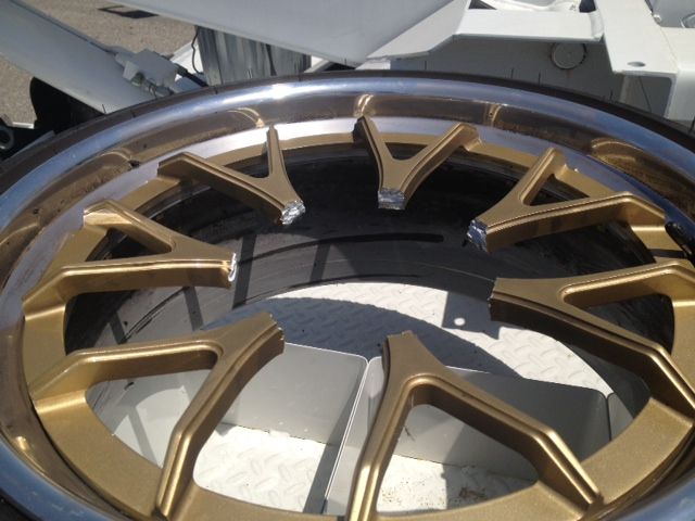

Hi Tay,
First, I'd like to say your experience sucks and I can definitely empathize with you. I want to ask though, are you sure the wheels weren't dis-assembled? I'm not saying you're lying, but I'm saying maybe the company you worked with wasn't 100% honest with you.
Take a look at the picture:
From the reflection in the lips, the paint looks awfully perfect in the crevices. In my experience, this is impossible without taking apart the wheels. Can you provide pictures from different angles? Maybe this one is just deceiving.
Again, I want to be clear that I am not saying you're lying but maybe your shop wasn't completely honest with you. And if they were dishonest about this, who knows what else?
Michael
The wheels are still in Cor's possession. If they are truthful, I am sure they would be able to tell you if the wheels were disassembled or not. I can assure you there were not.

Seems a little too perfect especially in the crevices for them not to be taken apart. They don't use paintbrushes to paint wheels...

Find it strange that everyone just ignores the fact that the wheels were obviously taken apart. Something is fishy.
As where the wheel broke i dont think its important if they where disassembled or not,they broke in a area which is not touched...,if the screws on the outside would have broken then ok,but this has nothing to do with disassembling....

How do you know the company he used isn't hiding anything else? How do you know the chemicals they used to strip the paint didn't damage the aluminum? So many unanswered questions but so easy to point the finger towards Cor. All I'm saying is that the OP has caused irreversible damage to Cor without conclusive evidence. Cor has offered to completely give him a new set of wheels or give him a full refund.
Also, no wheel company ADV1, HRE, DPE, etc., will warranty a wheel once they have been disassembled because you have no idea what they did with the wheel.

As previously mentioned, the failure happened in the center, not the edge where IF they were disassembled, could be understandable. I love the core encor but with a public situation like this, it makes me leery to replace my current set for them.
I don't believe there is any chemical out there used to strip paint, will change the characteristic of the aluminum (weaken). According to the first post, had they not denied his warranty claim this thread probably would have never existed? Hopefully you guys can get this resolved quickly.
If Cor is alleging that the wheels were taken apart and re-assembled and that act resulted in a catastphic wheel failure then please explain to us how you could improperly re-assemble a wheel to cause this type of failure.
What kind of paint stripper WOULD cause a metallurgical change causing damage resulting in a failure as we have here? This is not a rhetorical question. I'm not a metallurist and I'm simply asking.
How can the OP have caused "irreversible damage" to COR when all he has done is cite facts and support it with photographic evidence? We are assuming that the OP has cited these facts as truth and if the OP has been untruthful with the fact then COR needs to chime in and call him out.
@ OP - Has this wheel ever been involved in a collision or curbing of any type or been subjected to any use or incident outside of what is completely normal?
