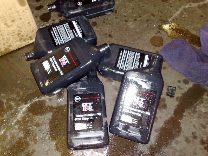

Will post up a more detailed procedure later tonight but for now.....
Dead soldiers everywhere

How many quarts of transmission oil did it take? (6 as the photo shows?)
Was it what the shop manual states? (I thought that was 10.)
The shop manual states 10.5 quarts and the procedure is really weird.
here is the FSM layout.
Draining:
1.Remove the front diffuser. Refer to Exploded View.
2.Remove the heat insulator.
3.Remove the filler plug
(Posted Image).
4.Remove the drain plug (1) and drain tube (2) from the oil pan, and then drain the transmission oil.
5.Install the drain tube to the oil pan. Refer to Exploded View.
When I removed the drain plug no fluid more than a drop came out. Once I removed the drain tube the trans fluid flowed for quite a while as it drained. So what that says to me is the fluid level is set by the height of the drain tube.

Install the drain tube and drain plug. Fill until fluid reaches the fill port. Replace fill plug. Run and cycle transmission. Then remove drain plug to remove excess fluid, allow level to drop to drain tube level. Replace plug. All good.
Well here in the interesting part. It took ~11qts of trans fluid to get to where there was overflow out the fill port. I then opened the drain plug expecting it to dribble for just a couple seconds. Oh no... started to recapture the fluid in empty bottles, got almost 4 qts back out of the trans before the fluid level reached the drain tube.
So I have no legitimate reason other than Nissan wants to make damn sure the trans oil pump it thoroughly submerged for the transmission to take 10.5 qts on a change. Then dump 4 qts or better back out of the trans. Otherwise this is the greatest marketing service ploy in the world to pad the bill. Throw away 4 qts @ 79.99/qt.
I am double checking everything in the morning then loading up to head to Mid-Ohio for NASA NAtionals. But best I can figure only 6 maybe 7 quarts of the magic trans fluid are needed for a routine change.

LOL! You're supposed to put the oil "in" the transmission...not on the ground.
:) j/k
I'm sure it's a bit of a pain without some sort of pumping system.

Yeah there is about $5 seeping into the concrete there.
