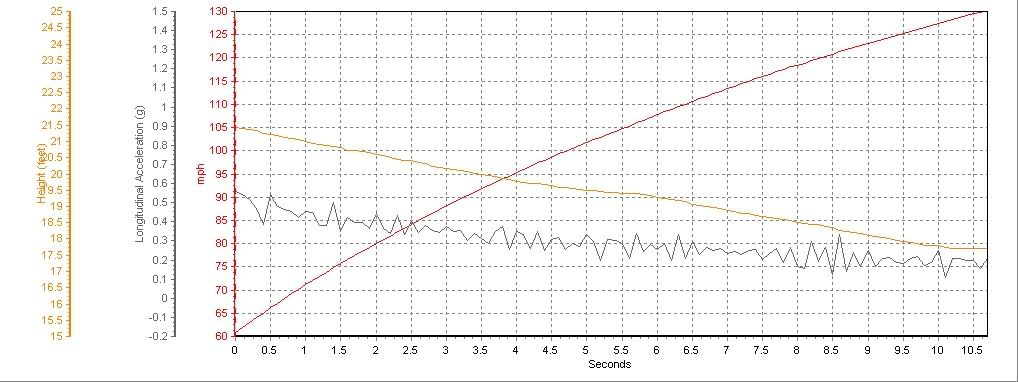

7/1/09, 9 pm Houston time, 90 degrees outside - GT-R with Y-pipe:
0-60 was 3.5
0-100 was 8.3
1/4 mile was [email protected]
60-130 was 10.69 seconds

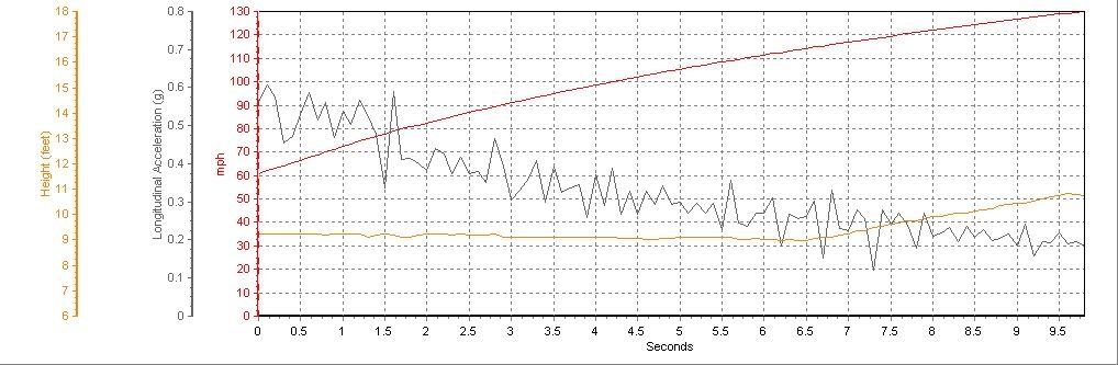

7/2/09, 9 pm Houston time, 90 degrees outside - GT-R with Y-pipe and stage 1 COBB:
A phone call into my good friend Dusty Womack of www.mvpgtr.com and the next day my buddy had a COBB Accessport. We loaded the stage 1 map and...
0-60 was 3.2
0-100 was 7.4
60-130 was 9.82 seconds
He was happy with the pick-up...all of us Houston fold use the 60-130 measure to guage real world performance pick-up as there is no launch involved and that range truly measures the capability of a street car. After those runs he said, "man, just a little bit more, and I'd be perfectly content". At that point in time I had spoken to several tuners and several companies that offered the e-tune product and the ONE that came to mind that I felt would be what my buddy was looking for was SHARIF at FORGED PERFORMANCE. He took my calls over the past week or so and took the time to answer my questions, return my calls, etc... He treated me like a customer even though I had purchased nothing from him. I called him up, my buddy purchased his custom e-tune and we uploaded it tonight. Results as follows:
