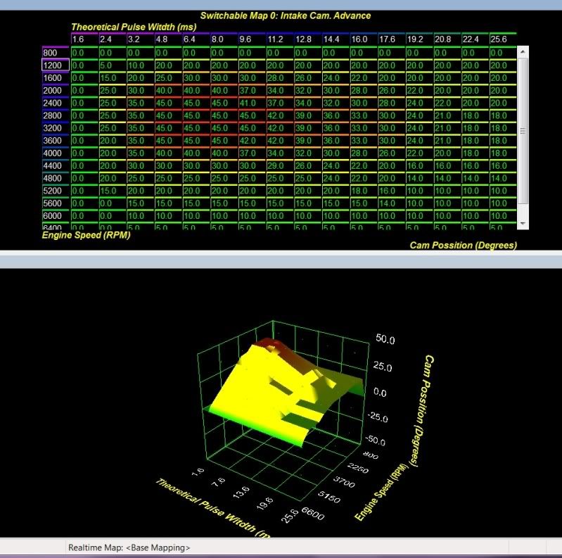

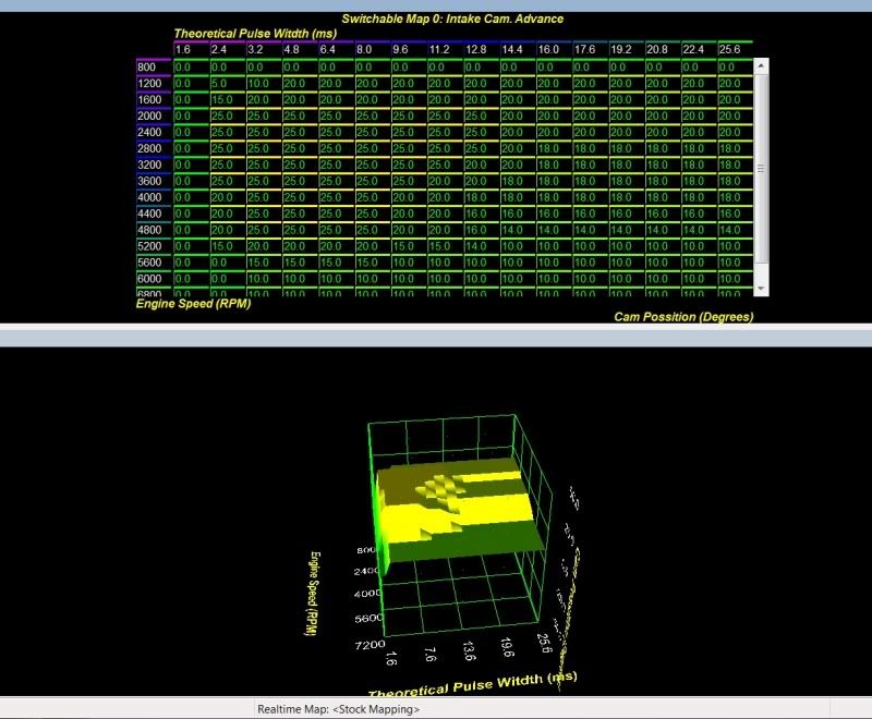

Thought some of you guys would be interested to see how some of the improved 2012 power can be contributed to Nissan cam timing tweek
2009
2012
We have our own little cam timing tweeks ourselves so don't worry too much tune guys don't miss out :postpics:
Great work from Thistle & Joe to open this up for us :)

Wow that is quite the difference even over the 2010/2011MY! Good work :helpsmilie:

Intake cam timing would be more of area under the curve and response based on my past experiences. Have to go back and look at a couple of dyno charts overlaid on top each other.
Although looking at it again, I am noticing the top line, top rpm, taking some cam timing out which should help the top a bit.
I think Inside Line did back to back testing on a CBA and DBA. Although dyno only will show so much.

There are two cam timing maps in the 2012, and the one shown is the more aggressive one which I'm assuming is used in normal circumstances. My EDM 2009 won't actually run over 38 degrees, will be interesting to see what the 2012 does. We found most gains from lots of intake cam advance during spool and virtually no effect from changes thereafter. So the stock 2012 map looks quite good.
