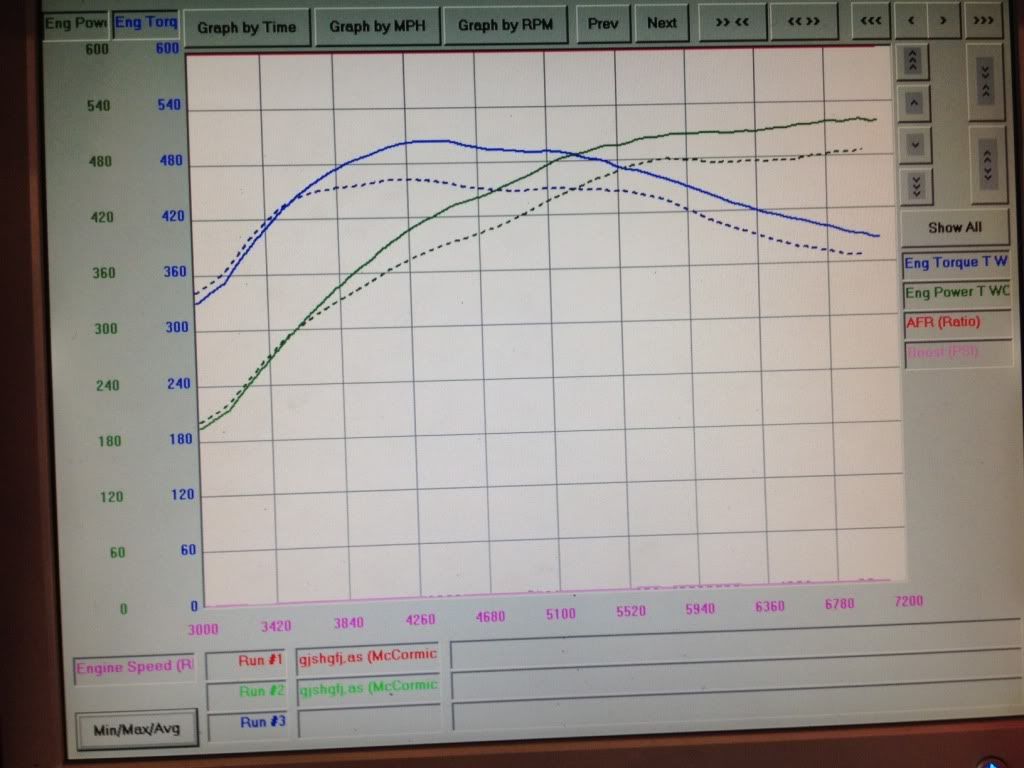

Here is the dyno graph for Cobb's off the shelf v3.6 map (highest boost setting) vs Jack Cecil's (HP Logic) custom tune map on my car. The results speak for themselves!! (The dotted lines are Cobb's tune and the solid lines are HP Logic's custom tune)
If some of you are wondering if a custom tune for your car will provide better results than an off the shelf map, hopefully this post will help you answer that question......

What were the WHP and WTQ numbers for comparisons.

Yes, I was using the Cobb v3.6 highest boost setting map file (93 Octane) to get 485 whp. I will do some data logging to see what the peak and final boost levels are with the HP Logic tune this weekend.
Peek boost levels should be around 21psi in 2nd if you start from a stop or floor the car low in the rpm range.
I ran the 3.6 stage 2 17.5psi tune at PBIR and did a 11.0 flat at 125.5mph. I then ran my custom tune and hit 10.8 @ 128.5. Same day same conditions. Stock runflats with LC2 at the time.
I only have an AAM resonated midpipe and a custom tune with stock downpipe, catback and filters.
