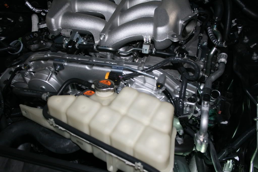

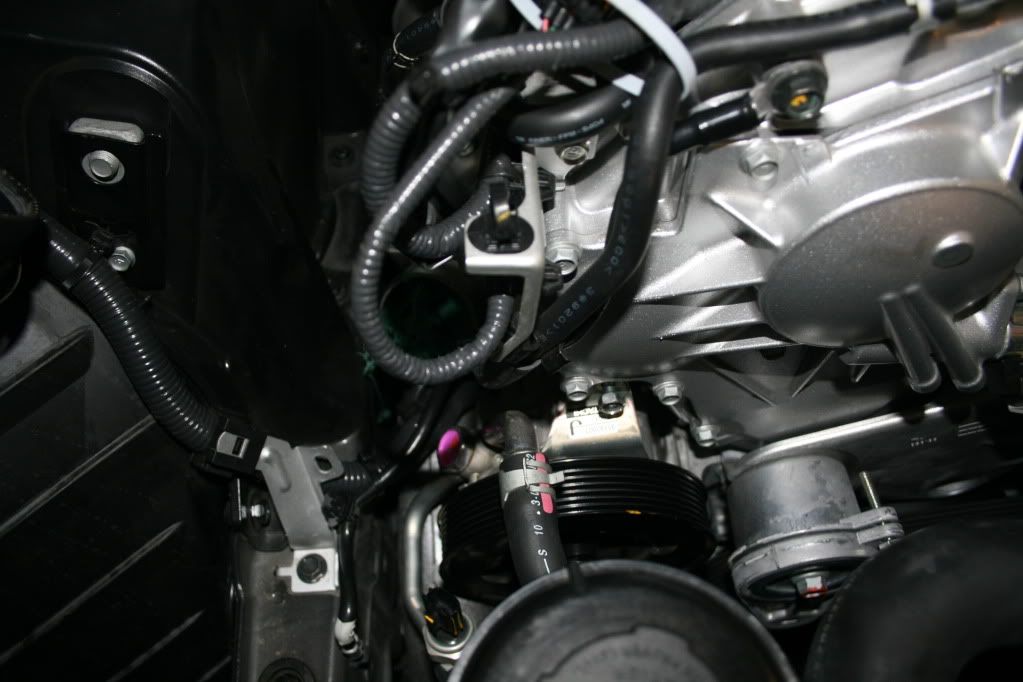

Ok, time for the driver side inlet pipe removal.
This was a little more challenging than the passenger.
1st thing I noticed was the coolant overflow was right in the way, so I unbolted it and moved it over with all the hoses still connected.
Unbolting the top nut was pretty easy, I slid a conbination of 12" and a 3" extension between the block on the AC Compressor lines.
Couple turns and it was out, now for the bottom, well this was a bit more difficult. I tried gettign to it from the engine bay with a series of different extensions and swivels etc and nothing worked.
I stated taking out the underpanels of the car, hoping to see an access point to get a socket in there. After removing under panel, through the fender well I noticed the bottom bolt.
From here I took the same extension used above and a short 6pt socket with a swivel and it was out in minutes.
Next I disconnected the vacuum line connected to the compressor housing, accessing from the fender well and then the vacuum line connected to the wastegate groing from the boost solenoid.
I pulled up on the inlet pipe and disconnected the haness on the solenoid and pulled the inlet assembly out of the car.

On the photo with the screwdriver pointing to the lower bolt on the driver's side pipe...what did you mean by "ratchet pointing to the rear of car"? What ratchet?
Also, from where (what angle and location) did you take this photo?
Great DIY pictorial!

1. If you remove driver's side wheel and jack up the car, you can easily access the lower bolt with 1/4 flex ratchet and no extension.
