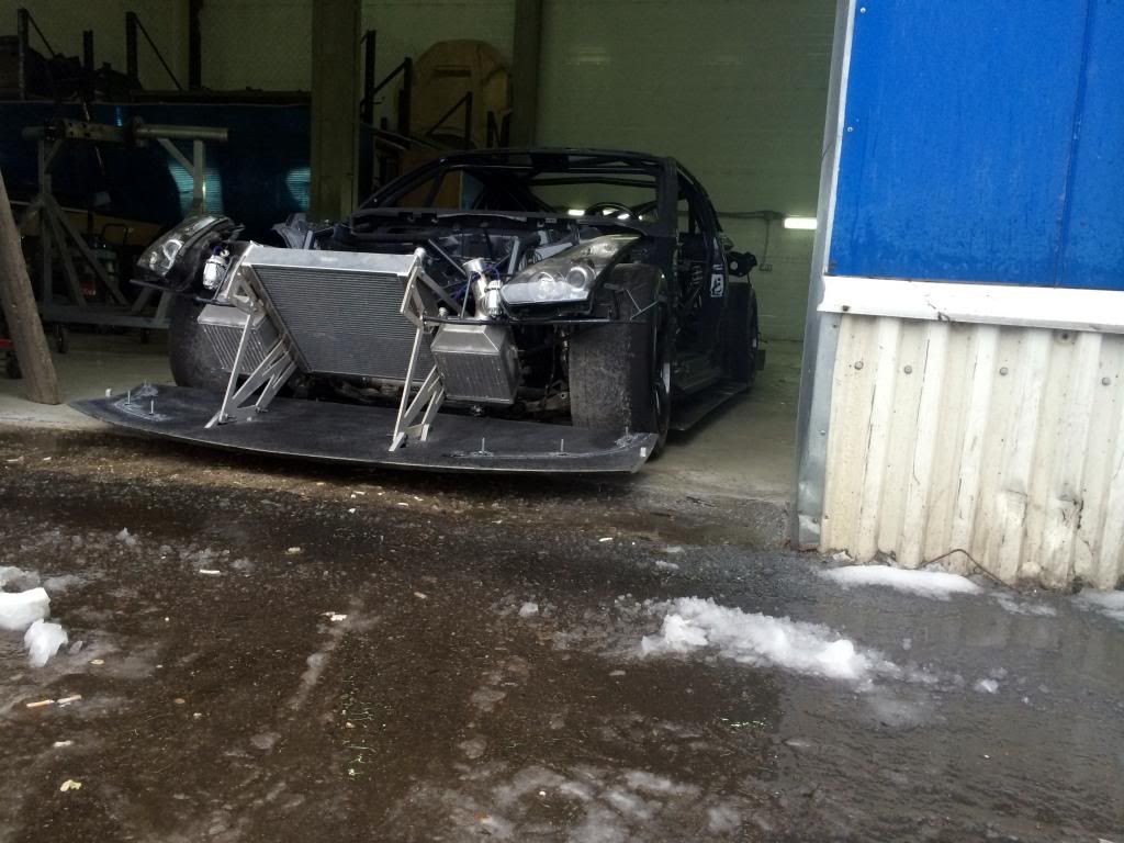

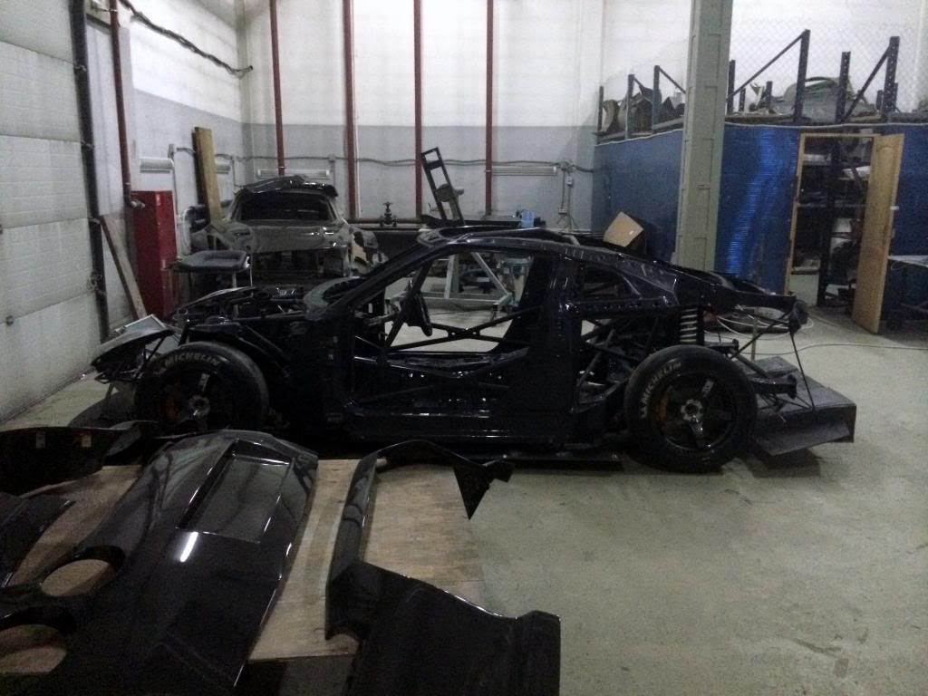

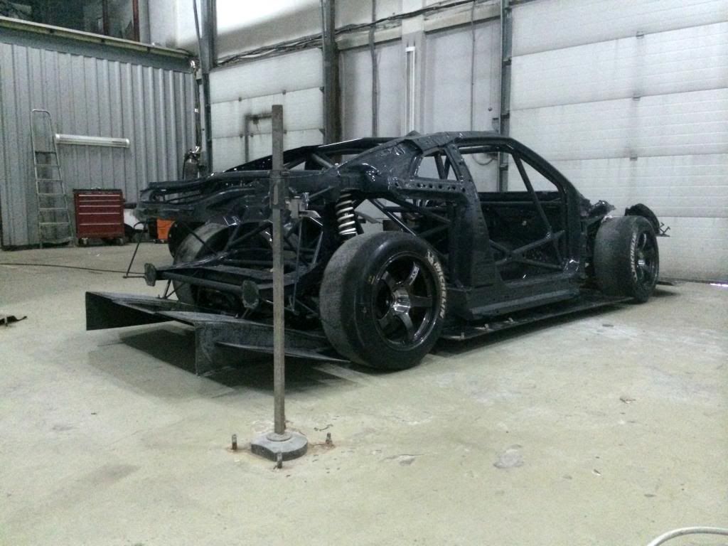

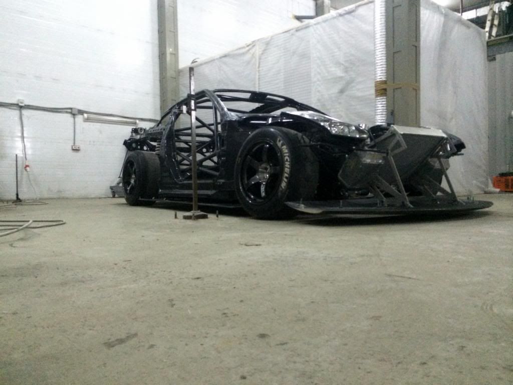

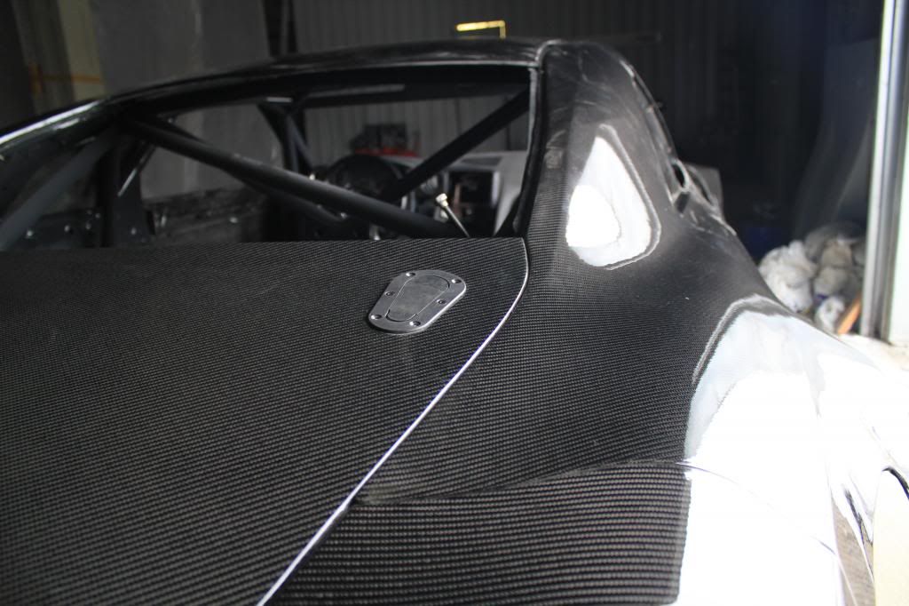

Project started at the end of September 2012 and about a couple of weeks ago we trial fitted carbon fiber bodywork. In order to adjust the gaps etc. Before we started to do that I could not resist to take some pictures. Please, keep in mind that this is not finished product - many parts are missing (but coming along nicely) like: two element high downforce rear wing (with measured Cl/Cd performance), grill and front ducting (ducts from bumper to radiator, intercoolers, brakes and from radiator/intercoolers to engine hood), side seals, mirros, etc. Car is standing on narrow 28/71-28 michelins on 11" wheels while it is designed for 31/71-18 (same as nismo/jrm used in FIA GT1 and now GT3 programm) on 13" wheels. So it looks funny and wrong but tires should be here fairly soon. Parts between rear bumper corners are missing and rear diffuser would be trimmed to it's final shape. It (diffuser) is also missing vertical strakes and vortex generators. I guess that because snow reflecting too much light or because of my non existent photographing skills it's not really visible that antire bodywork is clear coated (ultraviolet protection) carbon fiber... But in the flash it's visible very well
In fallowing posts I will share ideas/purpose behind various elements/solutions and go through some aspects of design/build process but for now I'm happy to share how it looked like (work in pprogress) during trial body fit

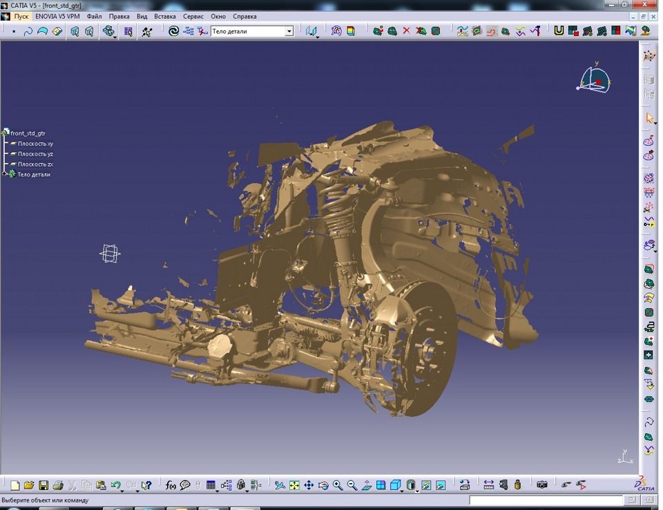

First step was to get a 3D scan of exterior geometry

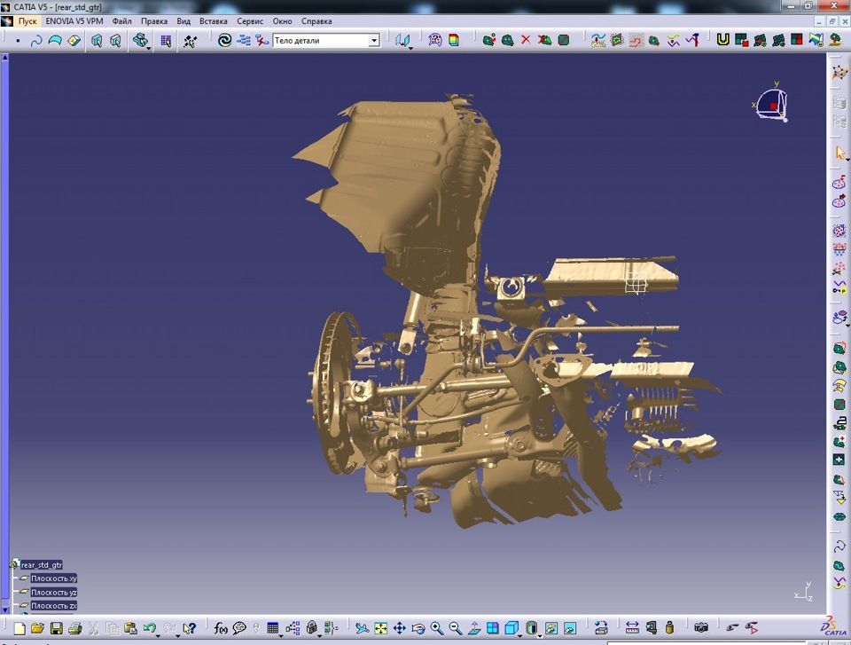

And front/rear suspension
From suspension 3D scan data one can locate its coordinates (every mounting/rotating point). After having it done one could create a model which in turn will allow to analyze suspension characteristics/behavior especially at drastically lower than standard ride heights suitable for race car. Also I always like to run the car through some simulation process: There you have a mathematical model of your car - suspension, chassis, aero maps, tire maps etc., etc. One can start with relatively low fidelity and add complexity to the model step by step and this will allow for better understanding of separate system impact on overall performance and most importantly how they interact with each other. Than one would drive this simulation by logged data (what people usually call telemetry data) from some track of interest - for example applying data from g-sensors as it was recorded on track. It will allow to learn myriad of things - how springs/bars with their particular motion ratios influence your chassis balance, how suspension geometry and its "anti" characteristics impact individual tire loadings (which ultimately decide chassis balance) on every single point on the track. Again there's myriad of things lo look at and to learn about but I just caught myself getting to long winded (again

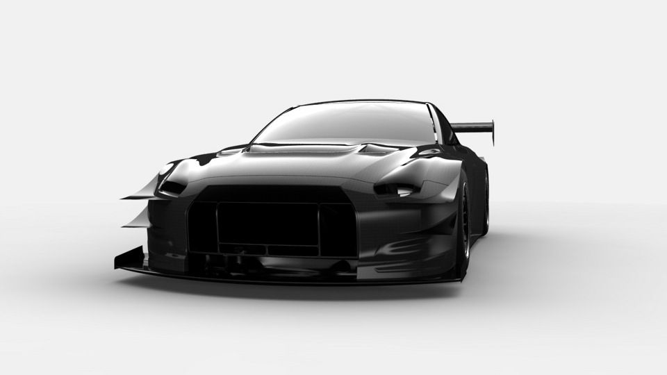

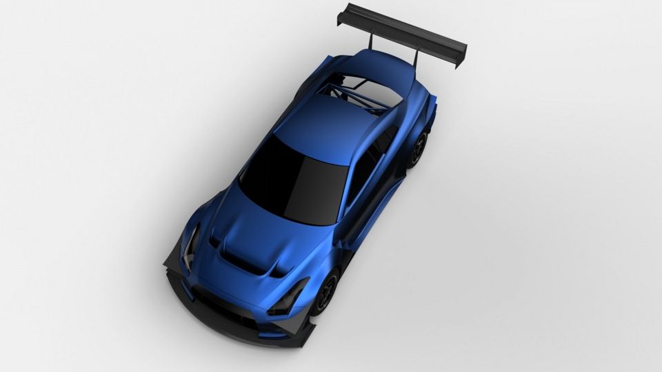

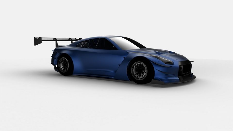

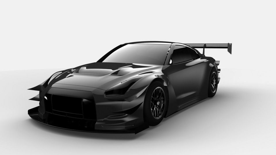

Exterior 3D scan data would obviously allow to design body work panels and aero package and work started on creating CAD surface model of bodywork and here's what we came up with.
It's obvious that we didn't invent anything new - it's very much similar to factory GT1, GT3 cars (to be expected because we where going to use same tires as they did). GT1 and GT3 engine hoods are different mainly because first was running NA V8 (based on VK56DE) and another is using standard FI V6.
Aero package is in many ways different because we didn't have tech. regulation constraints that they did. As a result it's more inclined towards Super GT way of doing things because SGT regulations give much more freedom than FIA series do.
Major effort went into trying to generate sufficient downforce on front axle. This led to heavy modifications of chassis/cockpit front corners to allow clear path for flow exiting front diffuser which in turn makes it much more effective. Area behind front wheels is designed around this and also to allow to extract high pressure air developing over front tires - again increasing front downforce.
Fully enclosed flat bottom (carbon fiber/sandwich construction) and rear tunnels/diffuser (again carbon fiber/sandwich) as large as standard rear subframe/suspension would allow to package. Two elements rear wing is placed significantly aft the rear edge (not allowed in FIA GT1/GT3) of the trunk - this way it will "drive" the underbody tunnels preventing flow separation and vastly increasing their effectiveness.
Aero was designed using CFD (CFX and Fluent) and in the March we plan to get the car in wind tunnel to fine tune the parts, develop aero maps, fine tune rear wing location for best possible interaction with underbody tunnels, test several designs of front dive planes (canards as the are commonly called in car enthusiast/tuner forums) etc. Than straight line testing to see how tunnel data correlates with real life (one has to remember that wind tunnel is still a model but not reality) and fine tune ride heights and final aero mapping (which than would be used in simulations that aid setup work).

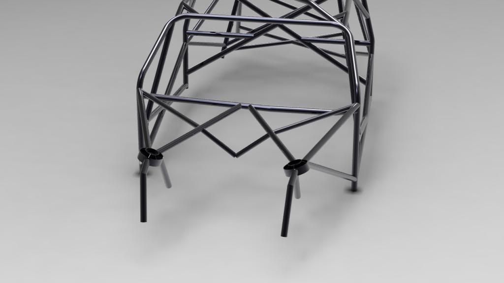

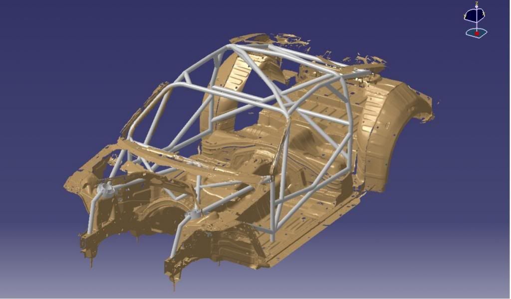

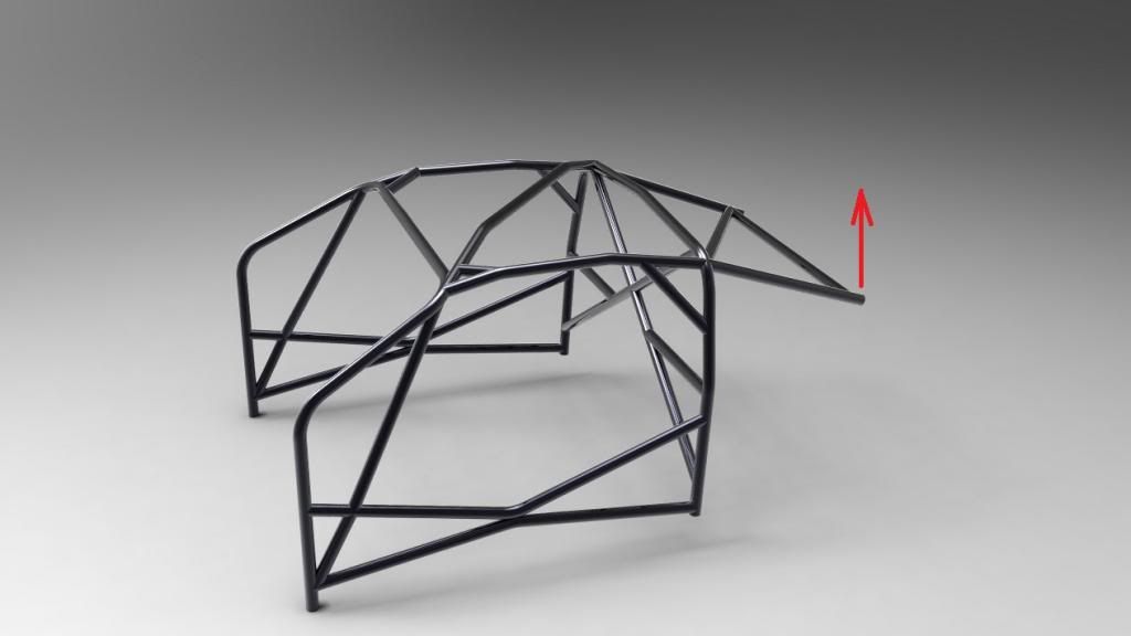

Seam welding was done and tubes finally arrived. I made a 3D model of Custom cages roll cage to integrate it in standard chassis 3d scan and than analyze it using FEA and some common sense.

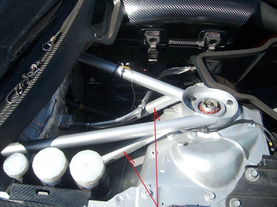

When one looks at English cage it's evident that they where mostly concerned with weight saving. That's to be expected because gtr is not famous for ultra light weight and in GT3 class power output would be restricted to near standard numbers. Also there's large restrictions in terms of how much of original chassis must remain intact and unchanged. Because of that (imho) - there's little rear suspension support and front suspension support is non existent. (I'm not trying to say they did it wrong, in contrary I think they did the best they could with given tech. regulation constraints)
On the above image red arrow shows direction of primary forces acting on upper rear damper mounts. It's evident that there's nothing to resist deflection in this direction. (In order to understand how chassis would resist forces imagine that its members/tubes are connected not by welds but only pinned together. For example a triangle will be stiff even if tubes are only pinned together and rectangle would not)

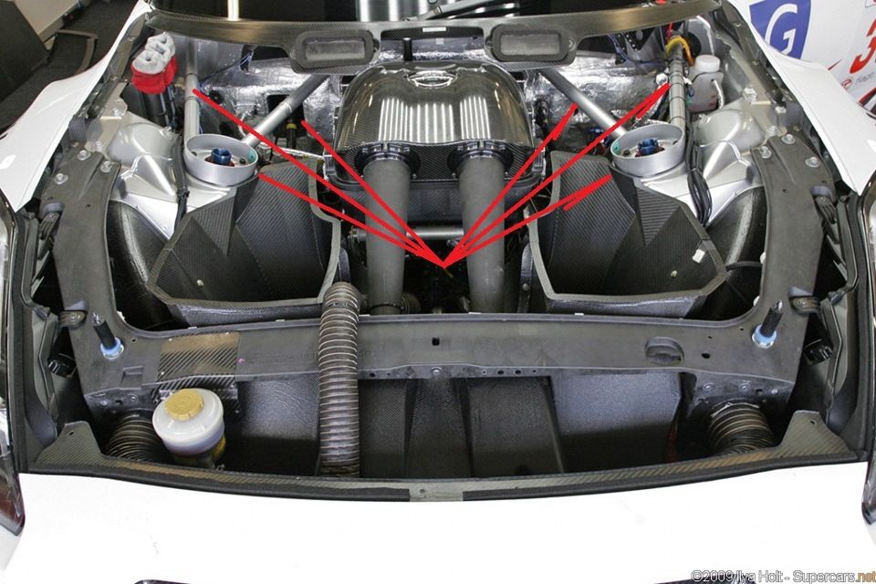

Regarding front part of chassis - here's a couple of screenshots taken from video of JRM testing GTR GT3 in spring 2013.
One can see that there's no roll cage extensions supporting front suspension. But if we look at FIA GT1 version (as well JRM) than there's entirely different situation:
There we can see front upper damper mounts stiffly tied to mid part of chassis (Red arrows). Four tubes form 4 triangles that effectively resist deflections in vertical and lateral directions. Similar solutions are used in Georg Plaza BMW 134 Judd, Australian V8 supercars etc.
I decided to go in similar direction and added front extensions to 3d model of English roll cage:

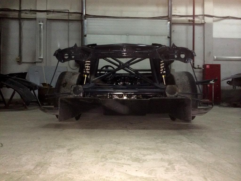

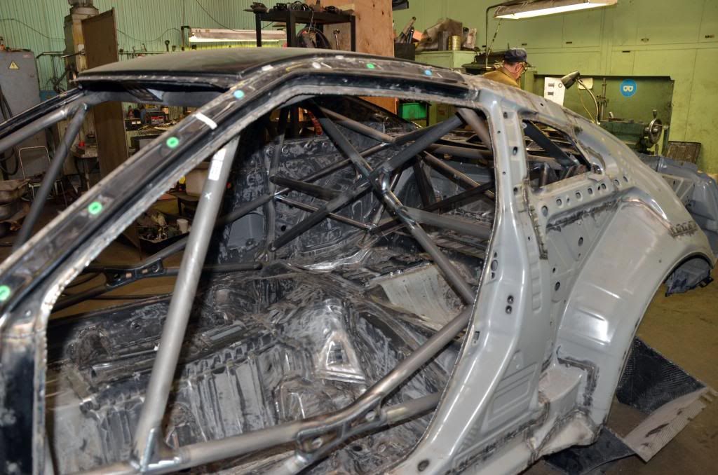

Than added rear part that stiffly tied rear dampers and subframe mounting points with rest of the roll cage and main standard chassis beams/members.
As a result we have a well triangulated tubular space frame integrated into seam welded factory chassis. This renders a lot of chassis parts useless and adding nothing but weight and it allowed to plan some careful but extensive cutting and saving weight as a result.

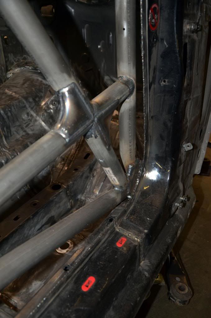

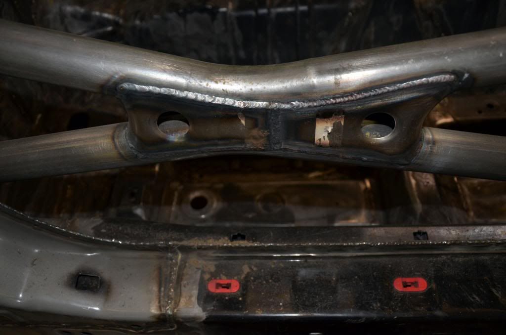

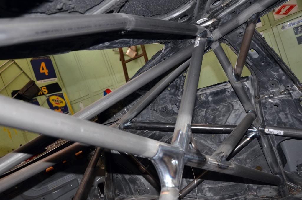

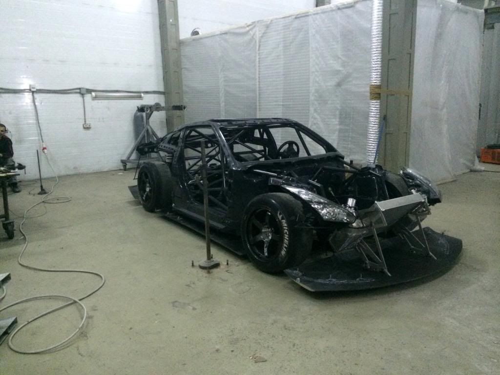

Than it was time to leave the CAD station and carry design over and into reality. That's how it looked than:

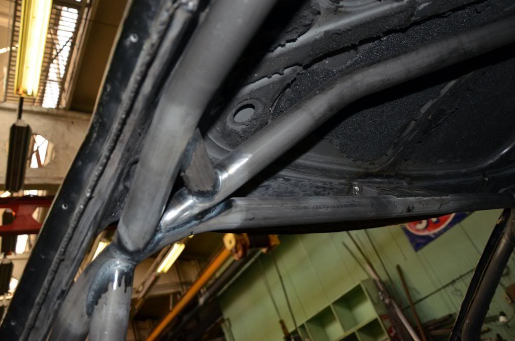

Every tube connection/node was sanded to clean metal, etched and every weld was made with meticulous attention to every minor detail.
