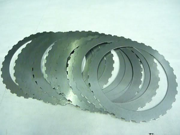

GTC 14 plate clutch system & steel plates & shims
