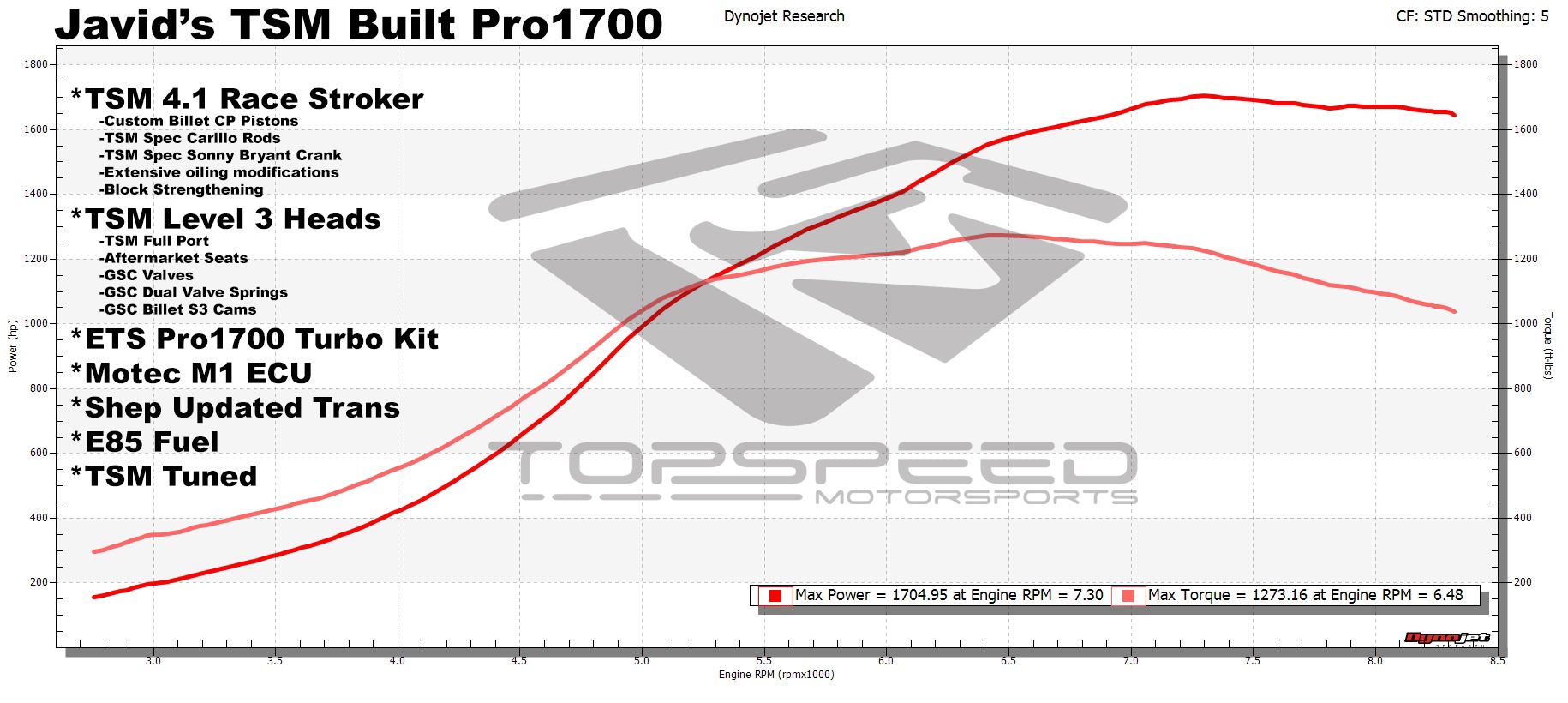

We set out to put one of our Race 4.1 long blocks in the car coupled with an ETS Pro1700 turbo kit. The cars need for block and heads really made this decision a lot easier. The process on our Race strokers is really a special one! I'm very proud of the R&D that we have put into these 2000hp rated cast blocks, and Javid knew it was the pick for him. With our Race long block we utilize our Level 3 heads. These heads are hand ported with reverse molded port matching tools as well as port matched perfectly using a flow bench. We use beryllium custom offset seats, as well as upgraded valves and springs of course.
The ETS Pro1700 kit is by far the best turbo kit we have had the privilege of utilizing for power ranging between 1500 and 1700hp. The kit comes with bigger downpipes and intakes to increase airflow, as well as some other little tricks that we will never tell
It comes pre-assembled from ETS so install is pretty straight forward. The kit easily makes 1700hp or so and honestly spools so quickly on one of our strokers that it leaves nothing to desire on the street. Javid can confirm that as he has been driving the car in Cali for several months now.

Saturday was the only day we got to run the car given weather that moved in on Sunday, however Saturday was all we needed. We started off easy just testing the car and track. Easing into things at low 30s PSI the car ran 191mph first pass out. Given the power setting I knew we were at I was quite pleased. Taylor and I reviewed the data for torque management as well as wheel spin and came up with a plan for pass number two. The goal on run number 2 was to break the 200mph barrier, which we knew wasn't going to take much. A little pinch of boost and some small changes down low were all we made and the result on run number 2 was 202mph!
Lunch Time!
Ok with a burger in the belly we went back to work! The car was happy! Really happy! Not even working really to run the 202mph pass, which was the fastest she had ever run already, so the day was already a win! I wasn't satisfied in the least yet. We were going to throw just another little sprinkle at it but I decided it was time to make some big boy passes. Turning the boost up to the low 40s we both knew it would be much closer to the "happy place". We didn't however know it would pick up 11mph over the previous run! That's right, the car ran an effortless 213mph absolutely drama free. I was surprised to see the slip. I assumed the car would go 208-209, but the pleasant surprise was more than welcome.
Ok…. so the goal had been met! 210+ was what the customer wanted and we surpassed that with ease. It was time to pack it in… right? I mean keep in mind I warranty this build with the full backing of Cicio Performance. The goal was met, the customer was ecstatic! Why try for more? If anything happens I'm reaching in my pocket to fix it….. All very good questions, but I didn't care! I knew there was more and I wanted it! 215 would make Javid freak the heck out, and I wanted that for him! He deserved it after all he had been through. The data looked as picture perfect as possible so lets lean on it!
Without getting stupid me and Taylor put together something we were pretty sure would crack the 215mph number on the next pass. We weren't greedy, there was more left on top of that but we didn't feel it was needed to do what I wanted. So we lined her back up after some very specific calibration and detailed changes to maximize not only the power, but the progression of power throughout the pull.
I drove the car, and if I'm being honest it was one of the most drama free, put together passes I have ever driven. The car laid power to the ground more efficiently than any car I have ever driven! It was smooth, power delivery was spot on, it felt fast but slow at the same time…
When I crossed the line I wasn't honestly sure how much faster it went. The car felt so smooth that I thought it was possible it didn't go any faster at all. Driving around to the timing booth I checked all the gauges… all was in order with zero issues. The timing gentleman holding the slip looked at me for a minute.. half stuck his head in the car and said "Holy shit, this thing looks damn near stock… that's amazing". He handed me the slip which read 219.8MPH!!!
I was so stinking happy I could barely contain myself. To be able to deliver RESULTS to this customer was very important to me. The car exceeded all expectations. Full exhaust, full weight, all factory interior, 20" tire, just like he drives the car all the time. It shattered all of our expectations going 219mph. I will say the car exceeded all we could have hoped for. Javid was jumping up and down about the 213 pass, but the 219mph run had him speechless!
