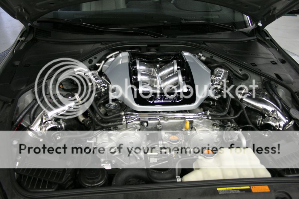

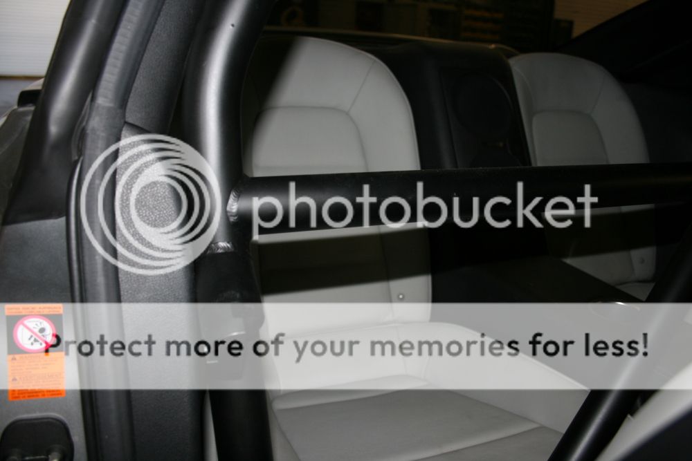

Here's another potent & powerful GTR added to the list. Enjoy

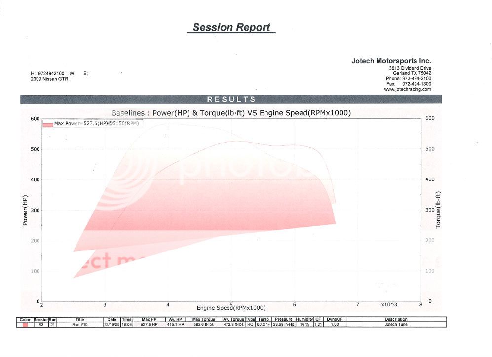

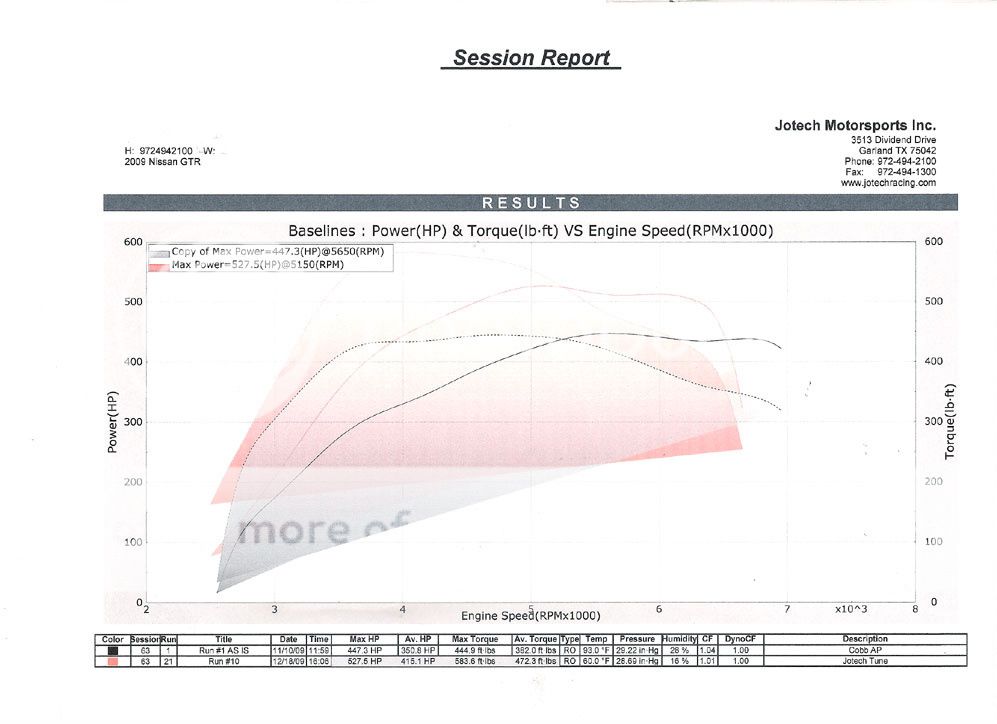

Baseline w/Cobb Stage 1 Map: 447HP / 444TQ
Power Mods w/Jotech Tune: 527HP / 583TQ (Net Gains 80HP / 139TQ)
- HKS Downpipes
- HKS Resonated Midpipe

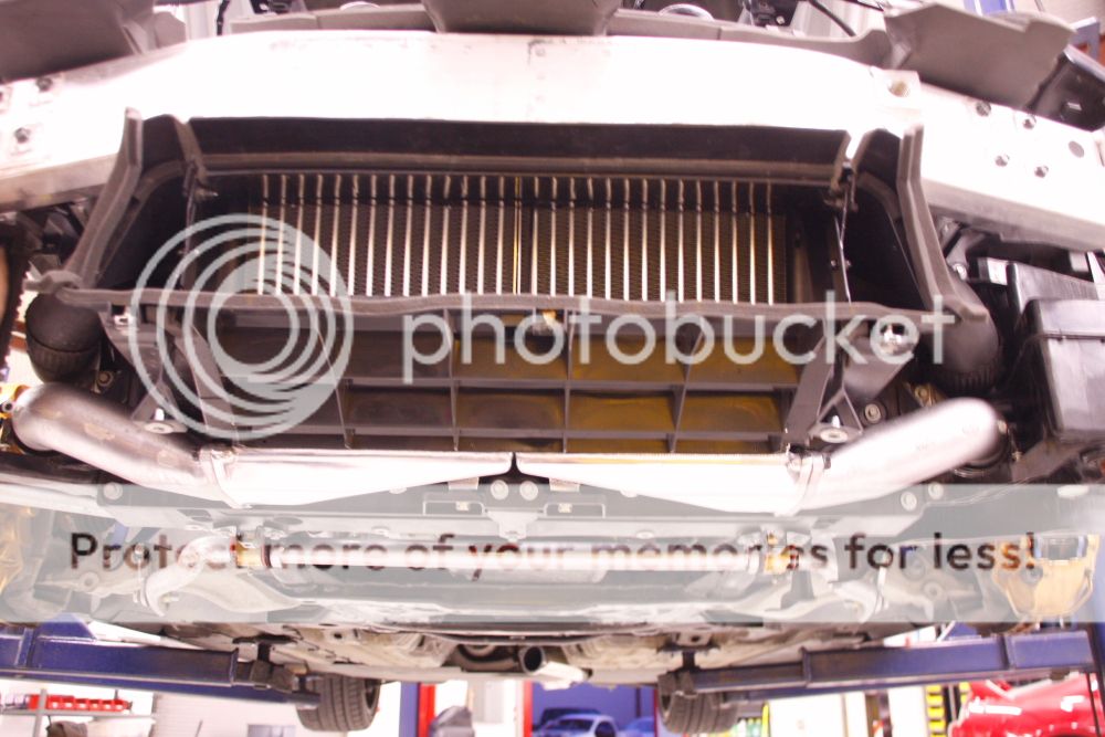

- HKS Stainless Legamax Exhaust
- Greddy Intercoolers

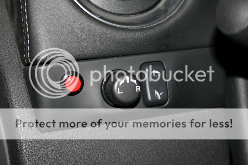

- HKS EVC 6 Boost Controller w/ Scramble Boost Button
- Cobb AP
- Eibach Pro Kit
- Stillen Sway Bars
- Carbotech Brake pads
- 18" CCW Wheels
- Nitto NT05 Competition Tires 315/30/18
- Stillen Front Spoiler Lip
- Roll Cage
- 4-Point Harness

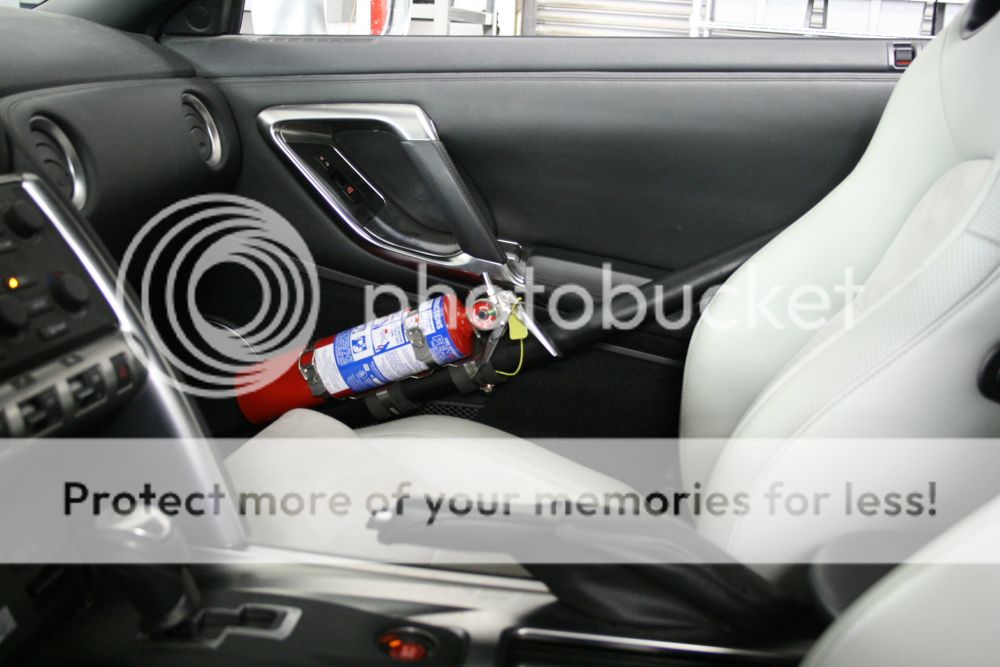

- 2.5lbs Halon Fire Extinguisher

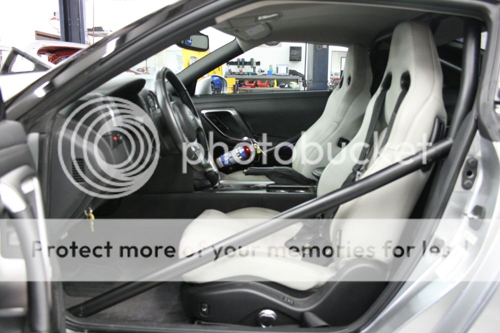

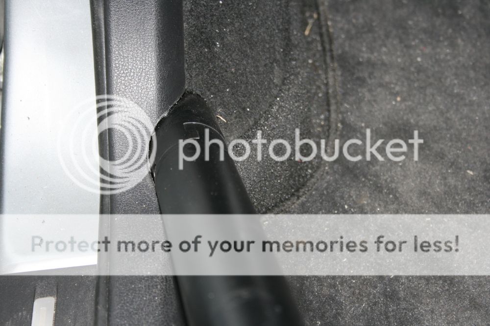

Nice. Big torque. I also like the removable side bars on the roll bar (cage - hard to tell from the pics). Is this car tracked? Drag? Both?
547 Posts
90% track

Nice work! I have very similar mods except for intercooler and we pulled a 540 awhp at HP logic but 500 wtq. Likely due to difference in dynos???
Most definitely on the dyno - noticed we always post a baseline of before & after.

I *need* that rollbar setup. Very clean. Nice work guys!

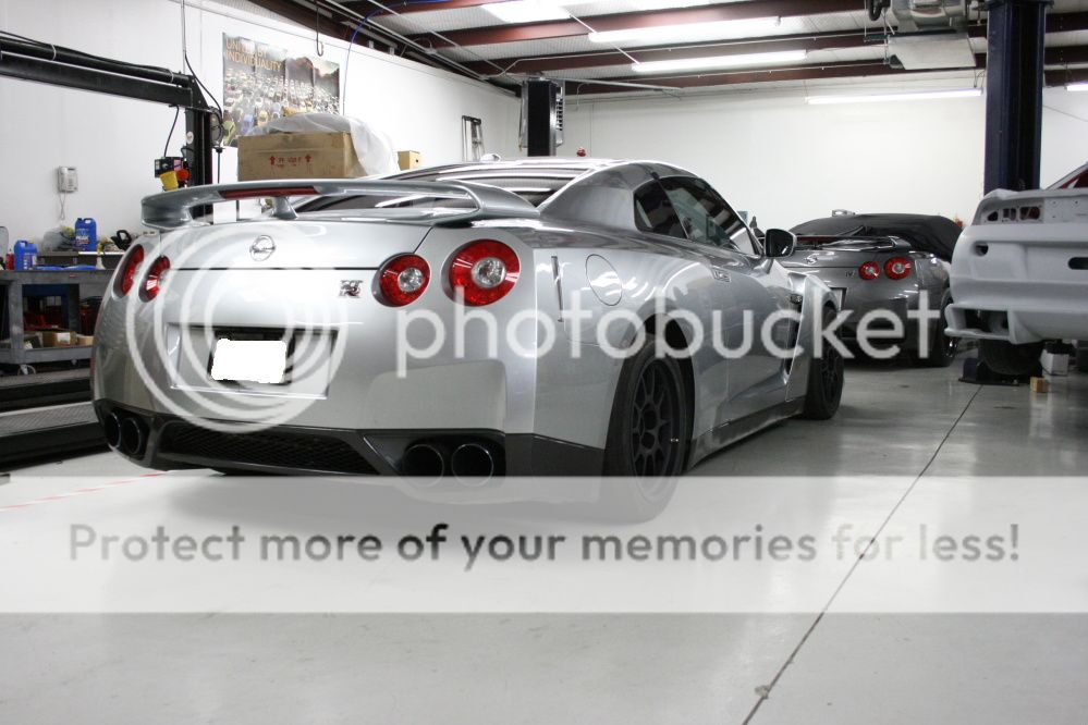

Updated Modification List For RN GTR:
Power:
- HKS Downpipes

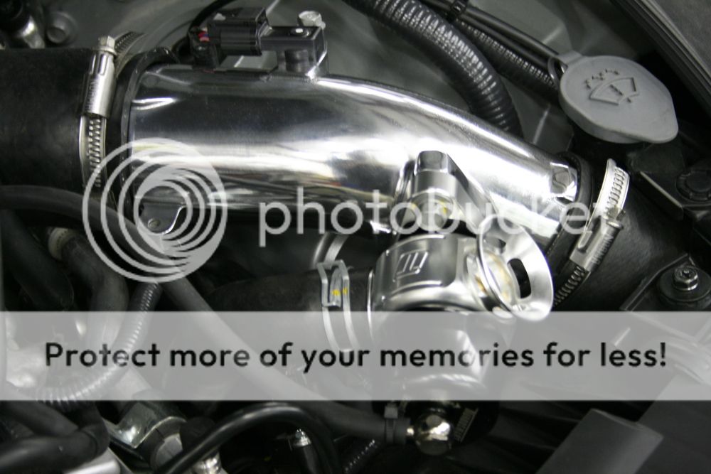

- Turbosmart BOV
- Cobb AP Jotech Tuned
Cooling:
- Cobb Engine Oil Cooler
- SSP Tranmission Oil Cooler
- Evans NPG+ Coolant
Suspension & Braking:
- Stillen / Penske 2-Way Adjustable Coilover Kit
- Stillen Sway Bars
- AP Racing J-Hooks
- Carbotech XJ-12 Brake pads
- Stillen Stainless Steel Brake Lines
- Castrol SRF- Synthetic brake Fluids
Wheels & Tires:
- 18" CCW Wheels
- Hoosier R6 Tires F: 315/30/18
Safety:
- 6-Point Roll Cage
- Status 4-Point Harness
Accessories:

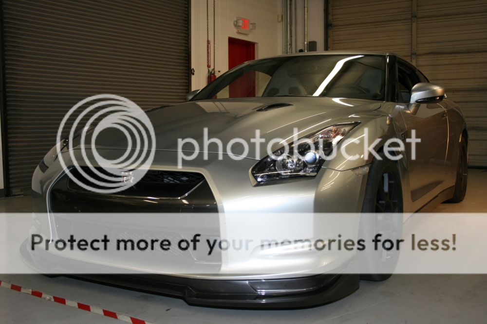

- Stillen Front Lip Spoiler
- Traqmate Datalogger

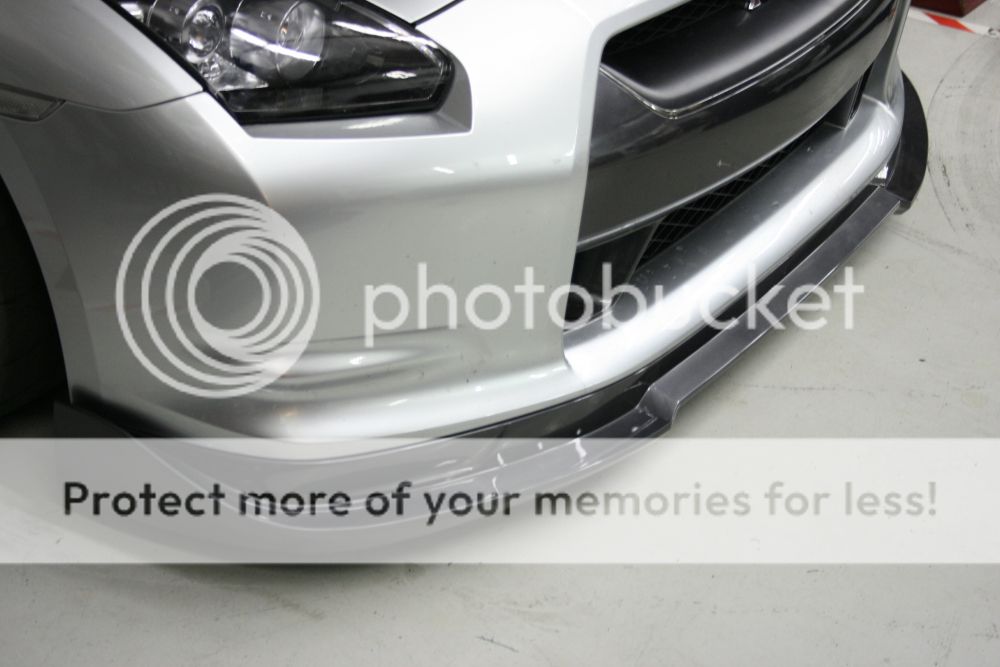

Very nice work, guys! Is there anyway to lower the car more without compromising it's handling? Car looks fantastic!
This is as low as it will go without compromising the handling.
