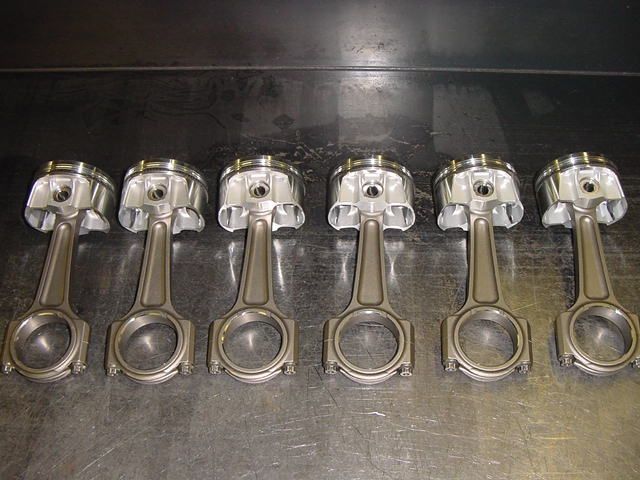

-JE Forge Pistons
-Manley I-beam rods

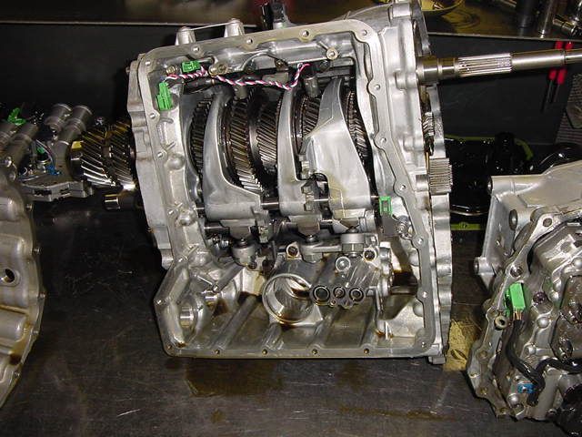

-RR transmission

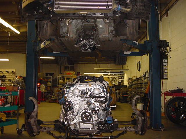

Car at Jacks
Pretty new parts!

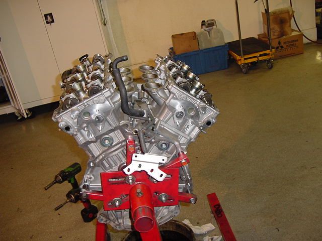

Engine getting all 'fancy'
Little transmission work

Engine looking pretty!
