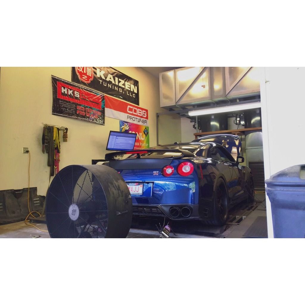

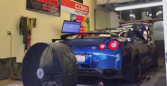

I had issues with my previous Protune on a mustang dyno. After posting my datalogs many approached and gave me the same feedback about my fuel trims, a/f being way off. I recently had a re-tune done on a dynojet by Rob from Kaizen Tuning. He did an amazing job, the car feels smooth, and I feel more comfortable after reading my new datalogs (not an expert in reading logs). (Datalog not uploading for some reason)

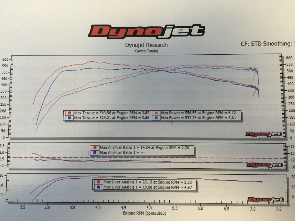

I managed to do a new datalog, i had the transmission on "R" mode because I wanted to hit 7K rpms. I was a little slow in shifting to 4th. Car went past 7k and shrugged a little, felt weird. I've been paranoid ever since I increased power and lost warranty. Is that normal, when going over 7k and slow shifting?

Looking at the dyno graph and anything above 6500 and your on the decline ?
Don't know your mods, but assuming bolt ons and stock engine, I wouldn't take it over 7k.
Looking at that graph I'd shift at 6700+/- and ride that 5000+ curve.

Yeah I normally shift way before, i just wanted to hit 7k to get proper datalogs. But as soon as it hit 7K it just jumped redlined and kind of hit back duno how to explain (similar to a single clutch kickback). Shouldn't be a problem right?

In R mode the car will let you hit the rev limiter. If you have not ever touched it before it can be alarming. It will make loud noises as well as bounce the RPM. In R mode throttle and ignition cut are set to the same RPM. In normal mode you will get fuel get about 100 RPM earlier. One is what I would call a soft limiter the other a hard limiter. It's hard limited in R mode so you don't have throttle closure.
Stop being paranoid and just enjoy the car my friend. You got nothing to worry about. Car looks to be running great!
