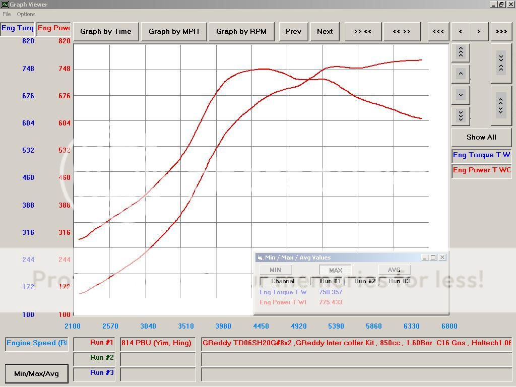

We have been working hard during these few months to test different methods of tuning software, different methods of turbo upgrades, etc for the R35 GTR. The Greddy turbo kit was first installed on our GTR few months ago and have reached torque numbers of over 738. Our customer Hing's GTR was also making over 750 in torque with the very same kit. Both vehicles were tuned with the Haltech unit. From what we've encountered was this mysterious "NO SHIFT" issue from 3rd to 4th gear. We've been working with Haltech to resolve this issue on a daily basis. We feel the TCM is definitely the reason behind this shifting issue once you reach high torque numbers.
SP Engineering GREDDY TT RACE MAP (HALTECH)
Hing's GREDDY TT RACE MAP (HALTECH)

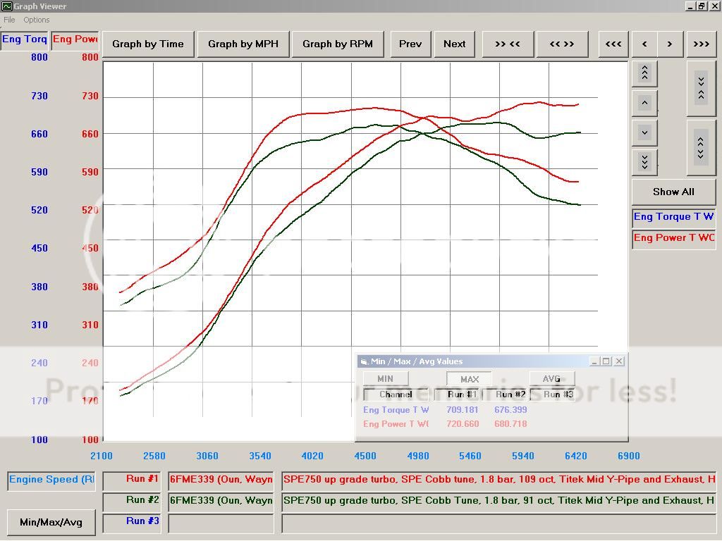

Recently we've completed testing the COBB software on Waynes GTR. We wanted find a solution to this NO SHIFT issue in order to acheive reliable and powerful packages for the community and to factor anything out at this point. 91 pump gas was first in line and achieved power gains of 680 awhp and 676 Torque. 109 race fuel was next in line and achieved power gains of 720 awhp and 709 torque. From what we've learned, this "NO SHIFT" issue will ALSO occur using the COBB AP once you've reach high torque numbers shifting between 2nd and 3rd gear.
Wayne's SPE750 Stage 1 91 Octane VS 109 Octane (COBB MAP)
This definitely proves the TCM is the reason behind the problems we've faced. I am also aware COBB is working on a TCM program which we are definitely counting on. Haltech is also working hard to find a solution as well. We have definitely acheived the limits of the TCM before any additional power can even be made and hope there will be a solution shortly in order for us to break the 1000 awhp mark.
