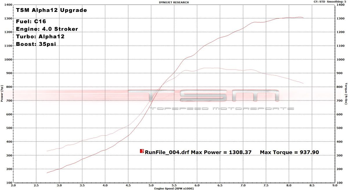

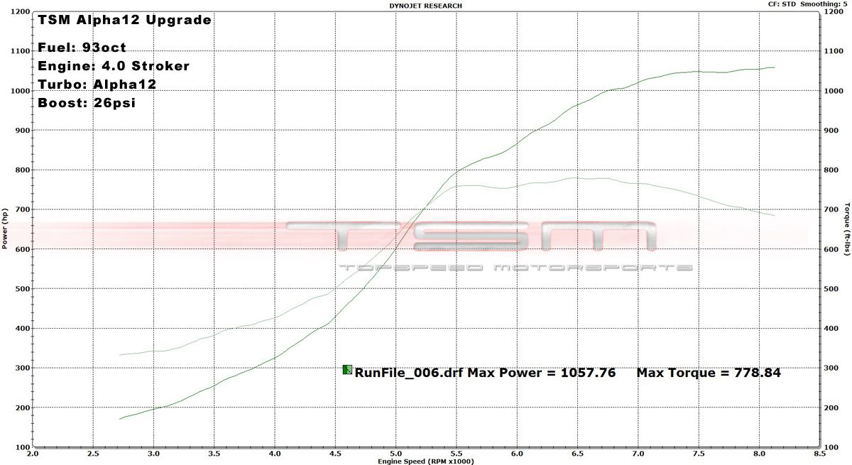

With all of these components combined this car left here as what I would call a tamed lion. She laid down over 1300hp to the ground on C16 and 1050 on pump gas! The sounds you get from the external dumps driving the thing down the highway are just amazing! The car just pulls and pulls! It really is the whole package, from great looks and aftermarket exterior mods to simply stunning performance.
