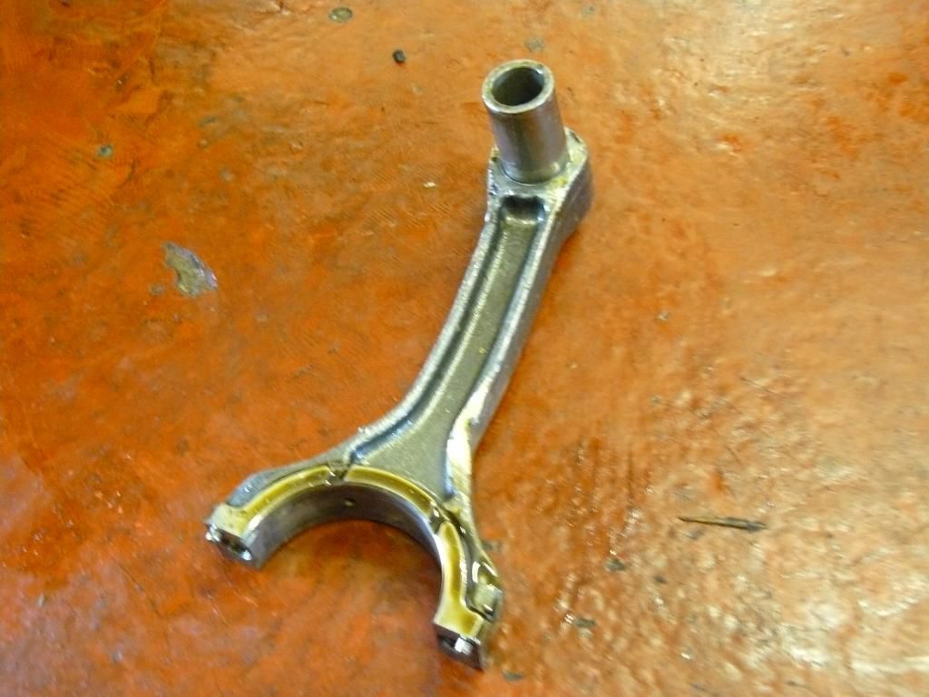

The problem is not just knock, though. The amount of power you're pushing. The stock con-rods are poorly up to the task of 600whp for a 3/4 mile stretch like at VIR. 530? Well, okay, but 600 and up, they can bend.
