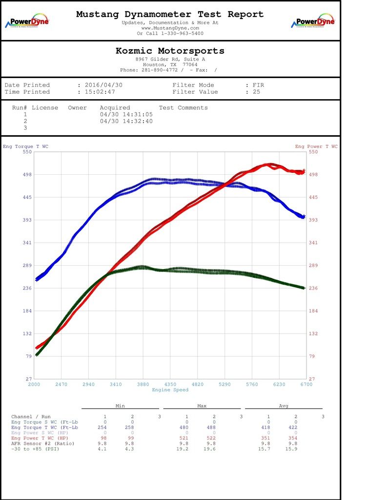

I just got back from Kozmic Motorsports here in Houston, Texas. I was on a Mustang 500-AWD-EURO dyno, which has a reputation here for giving very low numbers. I did three pulls on Slot 2 (18 psi) and three pulls on Slot 3 (18 psi), a somewhat more aggressive map. All pulls done in 4th gear and on Shell 93 pump gas.
Attached is my Dyno Sheet (corrected) with the highest pull from Slot 2 and the highest pull from Slot 3, overlayed on top of each other. I think you can ignore the AFR and Boost numbers below the graph....the shop didn't hook up a wide-band O2 sensor so not sure how the dyno thinks the AFR was 9.8 and my boost was 19.2 / 19.6...maybe some calculated value. Anyway, here are the results:
Slot 2 (18 psi): 521 HP; 480 ft-lb
Slot 3 (18 psi): 522 HP; 488 ft-lb
Kozmic said that if I were on a Dynojet, I could expect to see maybe 10% higher numbers, so that would put me around 574 HP and 537 ft.-lb.

What do people think about my numbers? Seems low or seems about right?

Do you have a "before" dyno? Or one from a stock car on that same dynamometer?
522 for FBO seems a bit low? Particularly with kit named "SBD700", in which, I assume, the "700" is supposed to be crank HP? That would imply a 178hp driveline loss, which, if it were true, would mean such a monumental amount of heat being dissipated by your transmission that the car wouldn't survive long.
I know all dynos are different which is why I asked about the "before". Mine bone stock 2014 made 505WHP on a dynojet (those read higher typically. But by how much?)
#10 · (Edited by Moderator)
I do not have a before dyno. But the shop said that stock DBA on their dyno see around 400 HP. So my SBD700 netted me about 120 HP to the wheels.
Yes, SBD700 means 700 hp at the crank and running on E85. I don't k ow how much crank an SBD700 is rated if on pump gas (but my guess is 625 hp crank).
But I may go to another shop to get the car run on a Dynojet, which I'm expecting to see maybe 575 hp, which is how much Kozmic believes it would make; and also how much Tim Bailey thinks it'll make.
As mentioned above, Dynojet reads about 10-15% higher than Mustang. That is because a Dynojet does not apply load (the weight of the car). On the other hand, a Mustang applies load on the car, to more accurately simulate the car driving on a street. I wished I had taken a video of it, but on the Mustang dyno, you actually see the car drop a few inches as it sits and nestles itself on the drums, because the drums actually open up horizontally to create a small gap, taking the full weight of the car.

Numbers seem solid for a conservative 93 tune on a mustang.

I likely we'll be getting another dyno done in a month or so--but this time on a AWD Dynojet so I can compare my numbers to I suppose is the "standard" dynamometer among the car community. I'm hoping for 575 hp and 540 ft-lb on an AWD Dynojet.

No they don't. Back in the 90s when cars had primitive non locking torque converter automatic transmissions you could maybe see that much power being lost between the engine and the wheels, and I guess multiplying your chassis dyno number by 1.2 gives one's ego a nice big number to talk about at Cars and Coffee, but that is simply not applicable to a modern vehicle, and the dyno numbers back that up. My bone stock 2014 GTR made 498WHP SAE corrected. The engine horsepower is SAE J1949 meaning that it makes what Nissan says it makes, plus or minus a couple of percent at most.
Borg Warner claims that the dual clutch transmission in a GTR is 94% efficient once in gear, so where is that extra 16% loss coming from, in your mind? A differential is about 98% efficient, so with two of them you might be looking at 10-12% driveline losses on a GTR *at most*.
