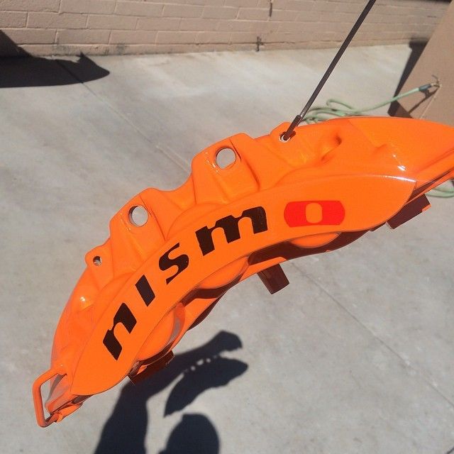

I'm interested in changing the color for my calipers. I wasn't sure if anyone has done this and what method they used? My local shop just recommended painting them with a high temp pain, but I'm a bit hesitant because I don't think that would be OEM quality.
Does anyone have any suggestions?

You'll want to put the sticker on prior to the clear coating.
#13 ·
You can get the stickers anywhere. You don't get them from Brembo. The stickers go on after the base color has been baked on. The clear is done with by powdercoat as well.
#15 ·
When doing the calipers, you remove the pistons and dust boots prior to coating and then reinstall them once the process is done.

By painting them, you wouldn't need to dismantle the caliper. While this is choice, IMO, most people would powder coat for its durability. I wouldn't worry about the sticker, if you cleared over it, it should be fine.
