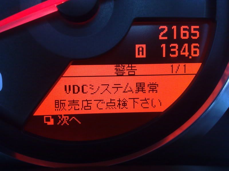

Hello all.
Been seeing the VDC off and the car with the slip marks plus the triangle warnings on my display for a day or so now. Here's a documentation of what's been going on.
Saturday about 1700 - use the LC to launch. Loads of fun. Then drove about 40 kms to get home, parked and went home. At about 730 or so, left to go to restaurant. Parked there - had food, came back at about 930 and the VDC Off light lit up.
Got back home, next morning took the car out - and the light didnt come on. Came back and as I was parking the car, the light came on. Left it at that.
Next morning (monday), took the car to work - no light. In the evening on the way home, the light comes on. and it has stayed on since. There is a warning message in Japanese on as well which looks like this:
Anyone got any clues to what's happening? According to whatever information I have been able to gather - some fail safe system's been activated due to an error in either the hill start assist or the VDC. The car is running fine, braking fine - no issues apart from these lights coming on.
Thanks

Tere/stealerhip/ everyone else Thanks a lot for your comments - most helpful.
A friend's wife reads japanese and this translates to - "VDC system is malfunctioning. Please check at the next service center immediately"

d-pak. Thanks a LOT for that. Going to meet up with alfcanada in a couple of hours - he is one of Cobb tuning's accessport beta testers here. The Accessport can pull the code out.
Since you ask, the Slip light AND the VDC OFF light are lit alongwith the triangle which is the master warning light. From my computations/permutations - think the issue is with the hill start assist, but need the code to confirm that. Lets see what it comes out with.
